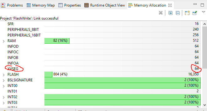

MSP430G2553: Create a new segment in memory to use for read/write during calculations
Part Number: MSP430G2553
I have the code example msp430g2xx3_flashwrite_01.c running and understand most of it. I can't use the existing INFOA-D (64 bytes each) memory segments though, because I need a bigger area. So I tried creating new segments in the free space between INFOA where it ends (INFOA-D are mapped in reverse) and before 0xC000 where the next item (FLASH) begins.
I tried a few different things and couldn't get any of them to work, so I made it real simple: declare a new segment the same size as INFOC (64 bytes) starting at 0x1100 and replace the SegC address location in msp430g2xx3_flashwrite_01.c with the 0x1100 address. It still doesn't work. Nothing else is different than the original working example, so it leads me to conclude that my new segment, which shows up under Memory Allocation if I select "show all", is not writable. Maybe I am just missing a setting for this? Has anyone successfully created new segments that they have written to? I could find a few examples of writing to flash in the forum but none that wrote to new segments.
Creating new segment in memory:

  • Perhaps I misunderstand your question, but so far as I know, there is nothing in the G2553 at 0x1100 other than possibly some part of the ROM-based BSL code that begins at 0x0C00.
    The G2553 has flash memory at INFOA-D and at 0xC000 - 0xFFFF, and nowhere else.  At least that's what the datasheet says.
  • You cannot use memory that does not exist. The linker command file just describes the hardware; telling the linker that there is some memory at a certain address does not create the transistors that implement the memory.
    If you want to have some new segment, you have to make some other segment smaller so that you have some actual memory where you can put it:
    XVSEG : origin = 0xC000, length = 0x0040
    FLASH : origin = 0xC040, length = 0x3F9E
    /*                 higher        smaller */
  • Thanks, I see this now.
  • Thanks, I will shrink the FLASH and add the new piece I need to store my calculations. I actually have 255 doubles (that's why INFOA-D segments aren't enough already), so I will carve 1024 bytes off the front of FLASH to use for XVSEG. I read that writing to flash is very slow. Is there any advantage to creating 255 new segments of 4 bytes each vs 1 segment for all of them?
  • The flash segment size (i.e., what you must erase at once) is 512 byte. This is a property of the hardware; you cannot change it.
  • XVSEG : origin = 0xC000, length = 0x0400
    FLASH : origin = 0xC400, length = 0x3BFF

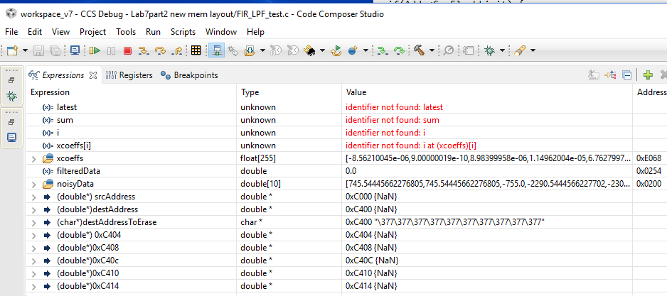

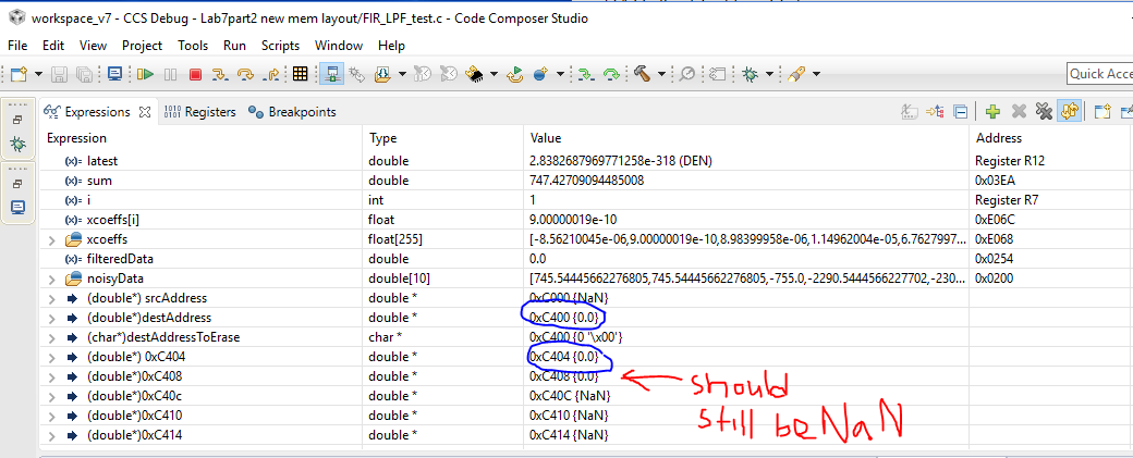

  • I have successfully created a new memory segment of 1024 bytes to house my 255 doubles (with 4 bytes of free space).
    FLASH : origin = 0xC400, length = 0x3BDE
    Since it was pointed out by Clemens Ladisch that a segment is 512 bytes, I am erasing by writing a zero at both 0xc000 and 0xc200 before writing.
    I can write a value and read it back, but only one. I can't erase before the next write because I need to be able to use the previous value in the future.
    I tried doing the erase and then unlocking for write and leaving it unlocked to do successive writes, but that didn't work. Nor did doing the erase and then unlocking and locking for > 1 write.
    Is this the way it is or is there something I can do to be able to write over and over again for one single erase? Attached is a stand alone test program to demonstrate the problem. I've scaled down NZEROS from 254 to 4, but problem is the same.

    Additional point, I found that, after erasing, there were NaN values in the segment, not zeros as I would have liked, so I had to write zeros in as well, in order not to break by sum when the array is still filling up. I.e. the first N iterations, the array is not full. One value is added each time (to the end), so it takes N iterations until there is a value in the front -- the oldest value having marched along to this first position. This is the "aging" I refer to above.

    After the erase, I see NaN at the memory location.  See screenshot: "Flash is initially". I am writing zero to the base address of each 512 segment. Should I be writing 0xFF? I have seen code that does that for other MSP430 models but the flash write example for this model wrote a zero.
    Then, when I go through setting what I assign is a double of 4 bytes to 0., it works the first time (at address 0xC400, but the next time through, it sets 0.0 to BOTH 0xC404 and 0xC408. See attached screenshot FIR zeroing too early. This happens again for i=2, i=3.

  • Writing 0xFF has no effect; it does not change anything from the erased value.
    After erasing, all bits are ones; for floating-point values, this is interpreted as NaN.
    The size of a double is eight bytes.
    When you are doing wear leveling, you do no longer know what value goes to which address. You write a newer version of the value to a different address (which is still erased), so when reading, you have to search for the latest version of this value.
