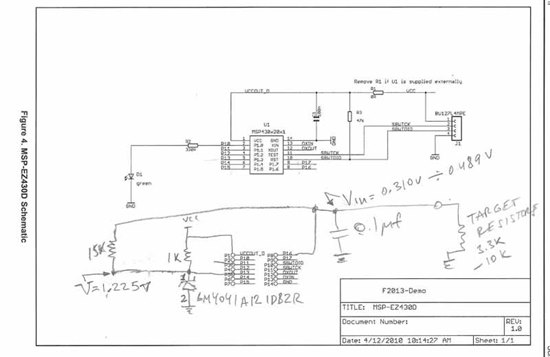

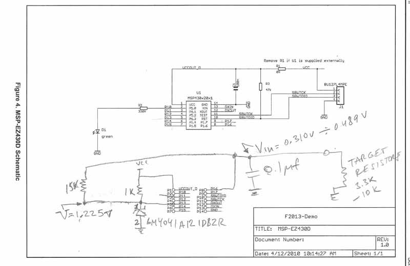

I added  1.225V external reference to MSP430F2013  pin 5.  I using ADC channel A3, P1.6 pin 8. If I test SD16 with external reference it is works fine, when I modified code for external reference - the first reading is good then 0xffff . What could be wrong ?
