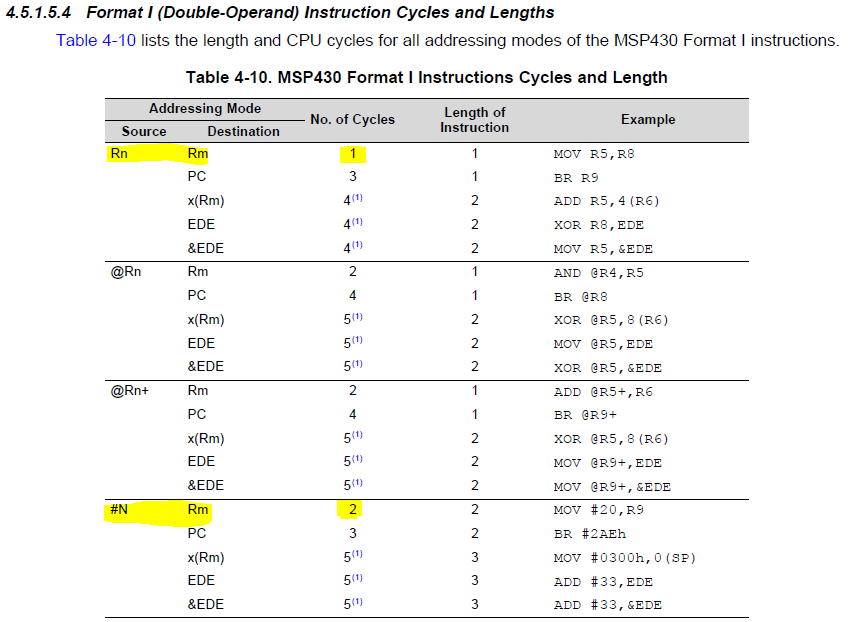

I'm working with assembly language and need to calculate exact timing for my coding. I do not see the difference between these codes, but according to the author they take different cycles to operate
	MOV		#dataBuf,	R12		                ;[2] load the &dataBuf[0]
	MOV		#DATABUFF_SIZE,	R13		;[1] load into corr reg (numBytes)
MOV #TX_TIMING_ACK, R5 ;[2]
whereas dataBuf is declared as uint8_t dataBuf[30], DATABUFF_SIZE and TX_TIMING_ACK are defined as constants. The numbers in [] are the number of cycles for the codes to execute.
I found the Instruction Set Summary from TI. But I got so confused from the sample project I'm reading as above mentioned.
Thank you for any advice.
  • What are the values of DATABUFF_SIZE and TX_TIMING_ACK? If these values come from the constant generator, you save ony cycle.
    And you should ask the author.
  • Hi Minh,
    all three instructions write a constant to a register which takes 2 cycles as can be seen in Section 4.5.1.5.4 of the User's Guide (slau367n). In case of the second instruction it seams to be possible to replace the constant #DATABUFF_SIZE with a constant from the Constant Generator (R3 & R4). In this case the data is written from one register to another which only takes 1 cycle.
    Thanks and best regards
    Christoph
  • Hi Clemens and Christoph,
    Thank you very much for your help. In the codes DATABUFF_SIZE and TX_TIMING_ACK are 14 and 20, respectively. So I guess we cannot apply the constant generator in this case. I don't understand why the author stated that. Maybe he/she was wrong...
  • Ah one more thing I'd like to ask. What are the formats of those instructions, for example, INC &var or CLRC? There are some instructions I don't know their types. Thank you.
  • Oh I'm sorry, I have not read carefully. The emulator of INC is ADD #1, dst
    Let me explain what I understand. For example with the code: INC &var, it will be ADD #1, &var ==> it will take 5 cycles as normal (the last type of Table 4.10). However because #1 generated by the constant generator, the final cycle will be 4 instead of 5. Am I right?

    those are emulated instructions that are meant to make the code a bit easier to read. They will be replaced automatically. INC will increment the destination by one while CLRC will clear the carry bit of the status register.
    INC R5
    is the same as
    ADD #1, R5
    while
    CLRC
    is the same as
    BIC #BIT0, SR
    Thanks and best regards,
    Christoph
    That is correct
