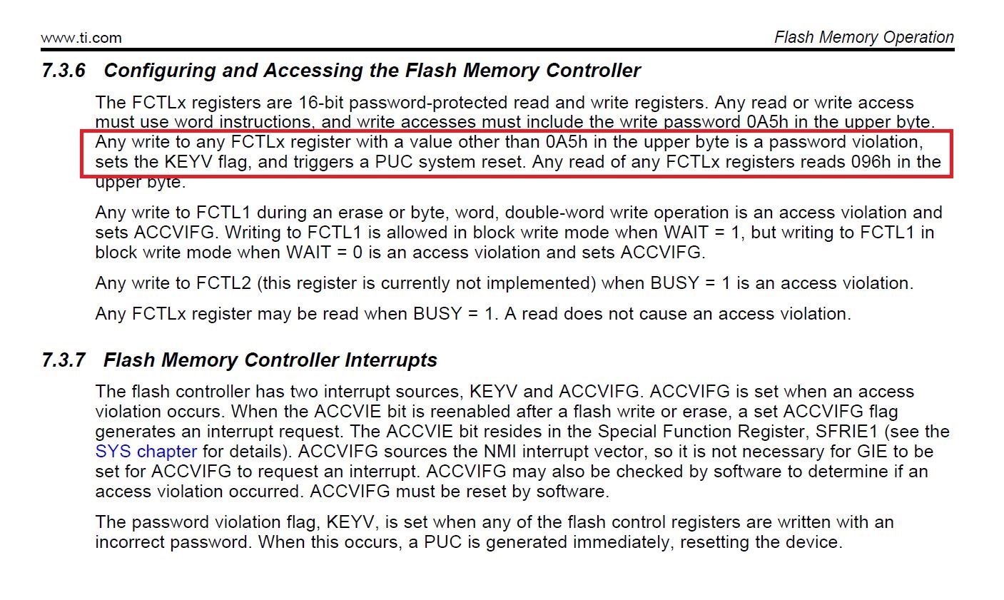

    The flag is Flash key violation. You can find the description in the MSP430x5xx and MSP430x6xx Family User's Guide (Rev. P).
    Winter Yu

    The strange thing here, is that the firmware doesnt write to the FCTLx register at all...
    We can see, during testing, that the reset is highly dependent on temperature, the reset occurs quite fast after the temperature is lowered.
    Some boards are also dependent on voltage supply.
    Are there any other sources for a reset like this?
    BR
    Anders
