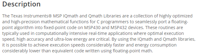

    For your application, you may be interested in the Fixed Point Math Library (MSP-IQMATHLIB).
