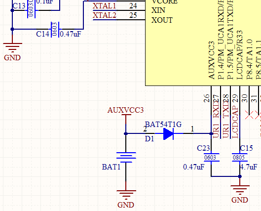

Hi anyone
I have a coin battery back up to the MCU via AUXCC3.
(The intention behind the battery backup is purely to keep the RTC & Backup RAM, powered..it is not to power the MSP in any of its modes.)
The board gets its normal power from another (failable) source.
When the main power drops, the battery kicks in.the RTC is supposed to tick over....except it doesnt.
I checked the 32k crystal via a scope probe on the one leg...that kicked in nicely when the battery kicked in.
The backup ram retained its data.
But the RTC...very strange...it retained the time that the power went down & then once power came back, it resumed from that time. So it means it never ticked over.
There is no indication that anything was amiss....SYSRSTIV, on startup, returns 2h indicating a brownout which is fine.
My setting for AUXVCC3...AUX3CHCTL = AUXCHKEY | AUXCHV_1 | AUXCHC_1 | AUXCHEN;
Any possible reason for this?
What can i do to determine more about what is happening?
thanks in advance.

    On the hardware side i have the following:
    My scope probe is on XTAL1 IN (pin24).
    Bench PSU to the battery is set at 3.3V.
    Ammeter on +ve wire sitting between the bench PSU and the battery holder.
    So the results:
    With the MCU running off normal main power, the backup mem+RTC_C are running (current drawn on bench PSU 1.2uA & scope  shows the crystal waveform).
    I check that the RTC_C is running via a comms program i wrote that communicates with my firmware via eUSCI and i see that RTC_C is ticking over correctly.
    The waveform DOESNT change in any manner when power is removed.
    I wait 30secs and restore main power & check RTC_C again....it has only progressed the 2 secs or so for my to disconnect main, reconnect main, & click my 'Get Time' button....ie when main power resumes, the RTC_C resumes with the SAME values it LAST had when main power was removed.
    This tells me that during the time main power was removed the RTC_C did NOT lose its contents but it also did NOT increment the time!
    The ONLY discernible difference between this test and the normal situation whereby RTC_C is powered by AUXCC3 is in the following:
    When AUXCC3 is DISabled (this test above):
    The 32K crystal waveform does NOT move when main power is removed and restored.
    And the power drawn remains constant at 1.2uA.
    When AUXCC3 is ENabled (the normal situation):
    The 32K waveform dips momentarily in the crossover from AUXVCC3 to battery.
    The power drawn under main power is 0A and when main is removed, the power drawn goes to 1.2uA.
    So...next step?

    For schematics:
    cheers
    moshe

    I started the debugger...
    i observed the 512Hz sq wave....great, the RTC is working.
    I observed the secs ticking over in the debugger.
    I observed the power draw on AuxVCC3 on my DMM to be 0.9uA.
    i then removed JMP11 & 4 for 5 mins.
    I observed the power draw on AuxVCC3 remained static at 0.9uA.
    I then restarted the debugger.
    I then stopped the debugger at the RTCRDYIFG & observed the RTCHR, RTCMIN, RTCSEC values...i noticed the progress was merely the time it took for me to disconnect JMP11&4.
    So NO...my RTC did NOT tick over when DVCC was removed!!

    AUXVCC3 is connected directly to the backup power supply (both PCB & target board).
    And from the scope probe i do see the XT1 oscillator continuing to run when main power is removed.
    And from my DMM i see the power draw to be 0.9 uA regardless of main power ON or OFF so i assume it indicates that everything associated with AUXVCC3 continues to function when main power is removed.
    So it would appear that something is set on power down that puts the RTC into a HOLD state. Where should i look for that?
    But i am also puzzled why Ryan's code makes the RTC continue to tick over under backup power yet my copy of Ryan's code does not....same code, same target board, same jumper settings(?), same MCU.

    Just to wrap this up for others who may have been watching this post.
    The suggestion of increasing Vcc cap WORKED!!!!
    i noticed the Vcc cap on the target board was 32uF and on my custom board it was 10uF...so i increased it to 32uF...so it would appear that the minimum cap on Vcc must be around 32uF if one wants the RTC to continue ticking over.
    QUESTION: why would the cap on Vcc have any bearing on what happens with the RTC ticking over??
    thanks again for your efforts
    moshe
