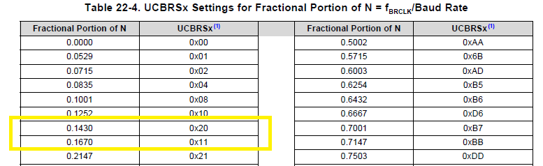

The MSP432p manual, on page 915, explains how to take a reference clock frequency and baudrate target and compute the baudrate register values.
To verify that I understand the instructions correct, I figured I would work through the table in the uartecho's hardware setup to make sure I get the same values.
For the 115200 baud config at 12MHz, I would expect the following:
        .outputBaudrate = 115200,
        .inputClockFreq = 12000000,
        .prescalar = 6,
        .hwRegUCBRFx = 8,
        .hwRegUCBRSx = 0x11, // 17
        .oversampling = 1
The Sx field, per the documentation, is a lookup in table 24-4 for the remainder of F/baud which is 0.1666 in this case.
What is odd is the value in the uart echo sample for Sx is 32.  At a 24MHz reference clock, I would expect that the Sx value would be 0x49, but the sample code uses 37.
Can you help me see where I'm misunderstanding the baudrate configuration computation?

    And the UCBRSx value is 32 (0x20) because of the lookup table in the calculator.
    N 104.1667
    For this case the fractional part of N is 0.1667 and 0.1667 is less than 0.1670 and greater than 0.1430 so UBRSx = 0x20.

  • I see now that the part I was misunderstanding is that the computation of the Sx value involves rounding down to the next smallest value in the tables instead of the closest value. Thus, 0.1666 rounds down to 0.1430 instead of up to 0.1670.
