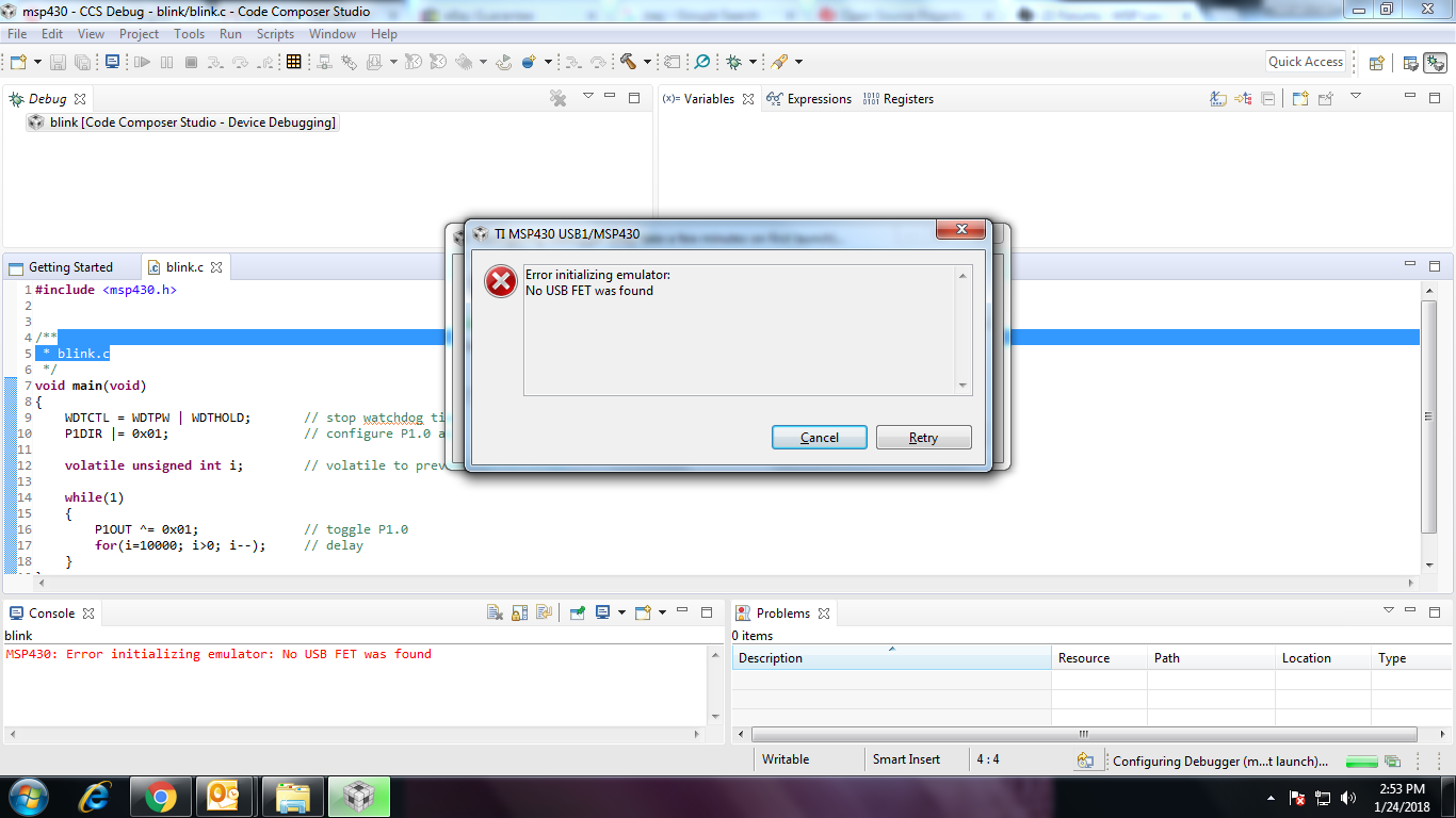

    As you suggested I have installed the ccs software and understood the working.But in debug session it is not connecting to the board it is showing this:
    I have a tdc1000-tdc7200EVM. Please guige me in this.
    That EVM is designed to allows users to evaluate the operation and performance of the TDC1000 ultrasonic analog-front-end with TDC7200 time-to-digital converter, so it does not contain the ezFET circuitry necessary to program the MSP430 over USB. To program the MSP430 on this EVM, you will need to use an MSP-FET. You can use this to program the JTAG on the EVM. Again, though, this EVm is designed to allow the user to evaluate the analog front end, so the headers needed for the JTAG are not populated. You will need to populate J1 with male headers. You can see this in the schematics that are provided on the EVM product page. It also shows the header part that you can use for J1 (again, it is not populated). Once you do this, you can use the MSP-FET with these JTAG connections to program the MSP430 with CCS.
