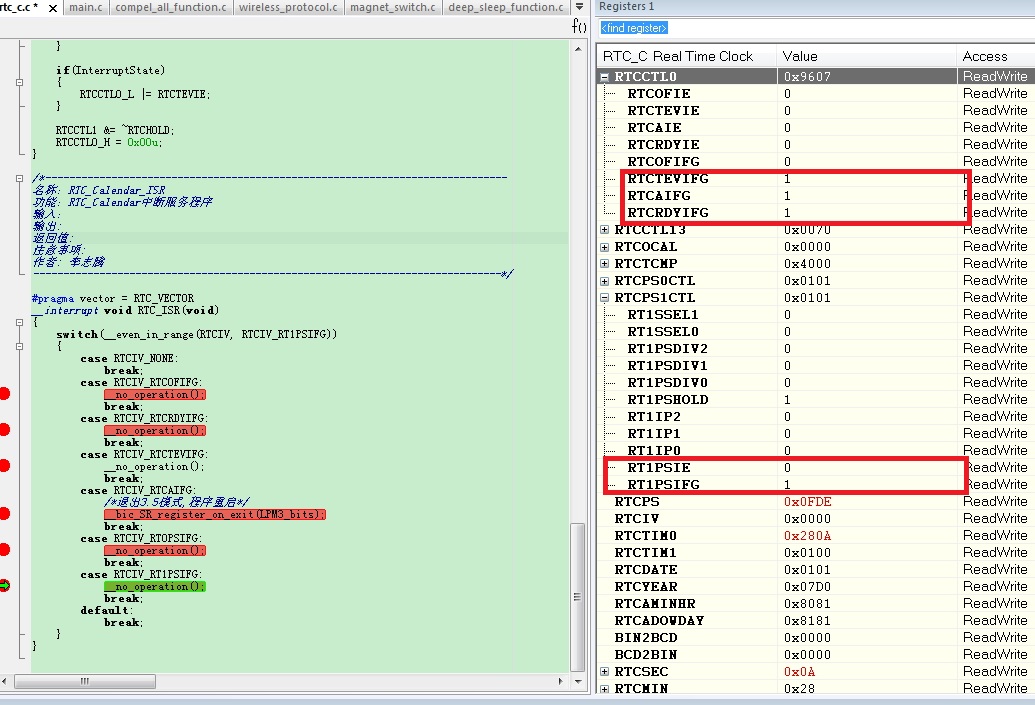

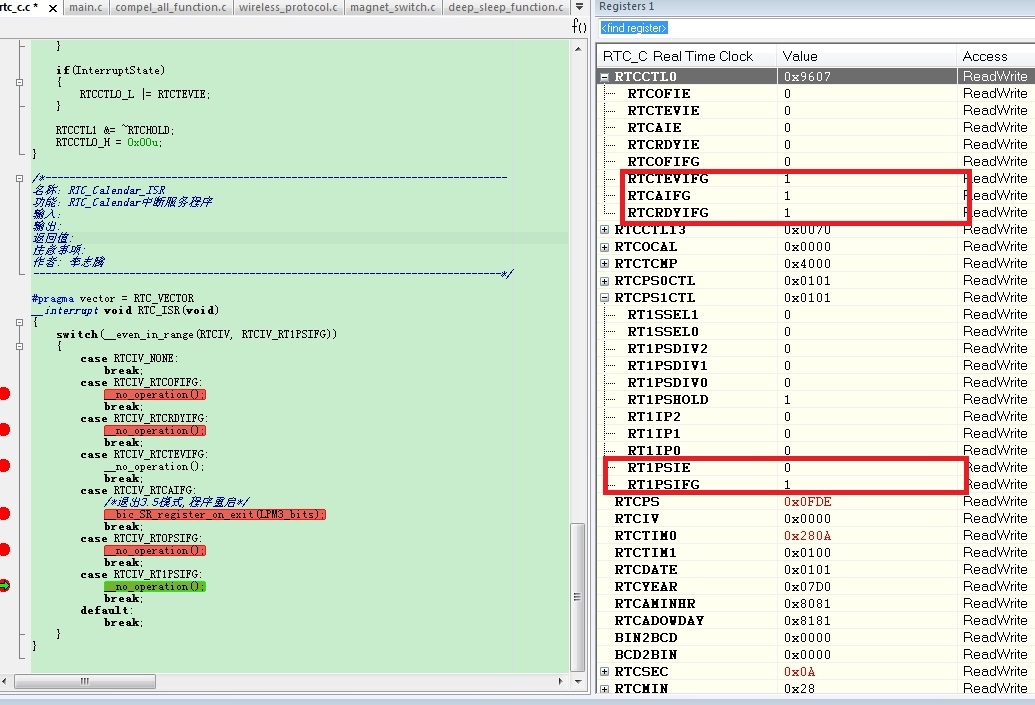

    I found when the cpu wake from LPM3.5  and  execute "__bis_SR_register(GIE);", the cpu will always enter RTC ISR. In the RTC ISR, cpu  execute "case RTCIV_RT1PSIFG " all the time .
  • the register value as following :
    when the cpu wake up, why is the RTCTEVIFG ,RT1SIFG will be set ?
    Best regards
    Jent

      // settings.
      PM5CTL0 &= ~LOCKLPM5;
      // Restore Clocks so that RTC will be read
      CSCTL0_H = CSKEY >> 8;                    // Unlock CS registers
      CSCTL1 = DCOFSEL_0;                       // Set DCO to 1MHz
      CSCTL2 = SELA__LFXTCLK | SELS__DCOCLK | SELM__DCOCLK; // Set ACLK = XT1; MCLK = DCO
      CSCTL3 = DIVA__1 | DIVS__1 | DIVM__1;     // Set all dividers to 1
      CSCTL4 &= ~LFXTOFF;                       // Enable LFXT1
      do
        CSCTL5 &= ~LFXTOFFG;                    // Clear XT1 fault flag
        SFRIFG1 &= ~OFIFG;
      }while (SFRIFG1&OFIFG);                   // Test oscillator fault flag
      CSCTL0_H = 0;                             // Lock CS registers
    #if defined(__TI_COMPILER_VERSION__) || defined(__IAR_SYSTEMS_ICC__)
    #pragma vector=RTC_VECTOR
    __interrupt void RTC_ISR(void)
    #elif defined(__GNUC__)
    void __attribute__ ((interrupt(RTC_VECTOR))) RTC_ISR (void)
    #else
    #error Compiler not supported!
    #endif
      switch (__even_in_range(RTCIV, RTCIV_RTCOFIFG)){
        case RTCIV_NONE: break;
        case RTCIV_RTCRDYIFG: break;
        case RTCIV_RTCTEVIFG:
          P1OUT |= BIT0;                        // Turn on LED
          break;
        case RTCIV_RTCAIFG: break;
        case RTCIV_RT0PSIFG: break;
        case RTCIV_RT1PSIFG: break;
        case RTCIV_RTCOFIFG: break;
    Winter Yu
  • Hi Jent,
    Besides, I think the  MSP430FR58xx, MSP430FR59xx, and MSP430FR6xx Family User's Guide (Rev. O) may help you. The section 1.4.3.1 Enter LPMx.5 and 1.4.3.2 Exit and Wake up From LPM3.5 describe the detail operation for using LPM3.5.
    Winter Yu
  • Thank you Winter,
    I found the reason is PM5CTL0 &= ~LOCKLPM5;. If I set PM5CTL0 &= ~LOCKLPM5 before init System clock , I program is ok.
    Best regards
    Jent
