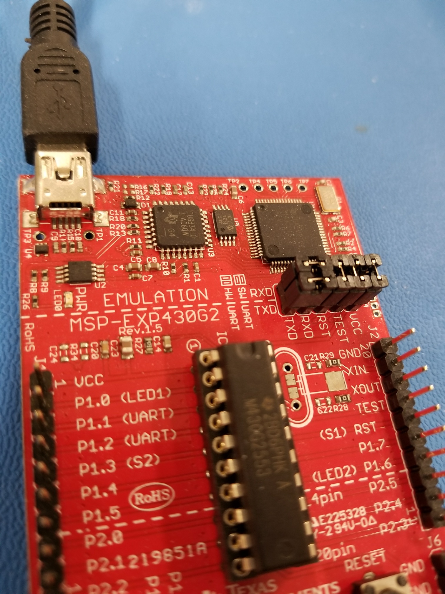

Hi. I am using IAR to program MSP430G2452 on Launchpad. I have sever questions.
1, Pin1.1 P1.2 marked as UART pins on the launchpad but User's guid and datasheet said that no UART function available on Pin1.1 and P1.2. So, is UART function available on Pin1.1 P1.2?
2, Since P1.1 and P1.2 are connected with F1612. How do I send char data to computer with UART?
I know about UART and I programmed F149 to send char data to computer with UART. Just the datasheet and User's guid of G2452 so confusing me.
Code samples can help me too.

    Try setting the RX and TX jumpers horizontal (=) instead of vertical (||).
    Then this code should work as an echo:

  • the 2452 variant does not have a uart inside, that's why the compiler gives those errors.
    options are:
    - find out how to code a 2452 bit-bang uart using an A_timer (check various sources)
    - if you can replace the 2452 with a 2553 processor, then you can use the uart hardware on the 2553 chip
    good luck !

  • Hi, I tried on G2553. But this program is not working.
  • Have you changed your RX and TX jumpers to the HW UART configuration as shown on the silk screen?
  • You will need to program with SW UART configuration, and then change the jumpers to HW UART (as shown above) for UART echo.
  • I changed it is working now. Thanks
