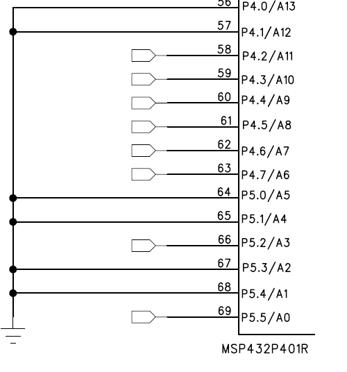

    Can you please share the configuration of the channels IO's as well. Please do note that we may not be able to provide every possible configuration testing due to the fact that we have just the LaunchPad.
  • Hi Amit,
    Currently the IO's pertaining to ADC are set as follows:
    	/* Set ADC readings as input to read with ADC */
    	MAP_GPIO_setAsInputPin(GPIO_PORT_P4, GPIO_PIN2);
    	MAP_GPIO_setAsInputPin(GPIO_PORT_P4, GPIO_PIN3);
    	MAP_GPIO_setAsInputPin(GPIO_PORT_P4, GPIO_PIN4);
    	MAP_GPIO_setAsInputPin(GPIO_PORT_P4, GPIO_PIN5);
    	MAP_GPIO_setAsInputPin(GPIO_PORT_P4, GPIO_PIN6);
    	MAP_GPIO_setAsInputPin(GPIO_PORT_P4, GPIO_PIN7);
    	MAP_GPIO_setAsInputPin(GPIO_PORT_P5, GPIO_PIN2);
    	MAP_GPIO_setAsInputPin(GPIO_PORT_P5, GPIO_PIN5);
    	/* SET ADC PINS TO LOW SO RESIDUAL VOLTAGE DOES NOT AFFECT ADC READINGS */
    	MAP_GPIO_setAsOutputPin(GPIO_PORT_P4, GPIO_PIN0);
    	MAP_GPIO_setAsOutputPin(GPIO_PORT_P4, GPIO_PIN1);
    	MAP_GPIO_setAsOutputPin(GPIO_PORT_P5, GPIO_PIN0);
    	MAP_GPIO_setAsOutputPin(GPIO_PORT_P5, GPIO_PIN1);
    	MAP_GPIO_setAsOutputPin(GPIO_PORT_P5, GPIO_PIN3);
    	MAP_GPIO_setAsOutputPin(GPIO_PORT_P5, GPIO_PIN4);
    	MAP_GPIO_setOutputLowOnPin(GPIO_PORT_P4, GPIO_PIN0);
    	MAP_GPIO_setOutputLowOnPin(GPIO_PORT_P4, GPIO_PIN1);
    	MAP_GPIO_setOutputLowOnPin(GPIO_PORT_P5, GPIO_PIN0);
    	MAP_GPIO_setOutputLowOnPin(GPIO_PORT_P5, GPIO_PIN1);
    	MAP_GPIO_setOutputLowOnPin(GPIO_PORT_P5, GPIO_PIN3);
    	MAP_GPIO_setOutputLowOnPin(GPIO_PORT_P5, GPIO_PIN4);
    As you can see, not all ADC channels 0-13 are used for actual readings. There was intentional space left between certain ADC pins which we found were causing a sort of "residual capacitance" noise on the ADC pins right next to each other.
    Schematic below shows nodes which are reading ADC signals.
    Prior to all of these settings, we initialized the IOs as follow:
        // Terminate all remaining pins on the device
    //	P1DIR |= 0xFF; P1OUT = 0;
        P2DIR |= 0xFF; P2OUT = 0;
        P3DIR |= 0xFF; P3OUT = 0;
        P4DIR |= 0xFF; P4OUT = 0;
        P5DIR |= 0xFF; P5OUT = 0;
        P6DIR |= 0xFF; P6OUT = 0;
        P7DIR |= 0xFF; P7OUT = 0;
        P8DIR |= 0xFF; P8OUT = 0;
        P9DIR |= 0xFF; P9OUT = 0;
        P10DIR |= 0xFF; P10OUT = 0;
    Thank you!
