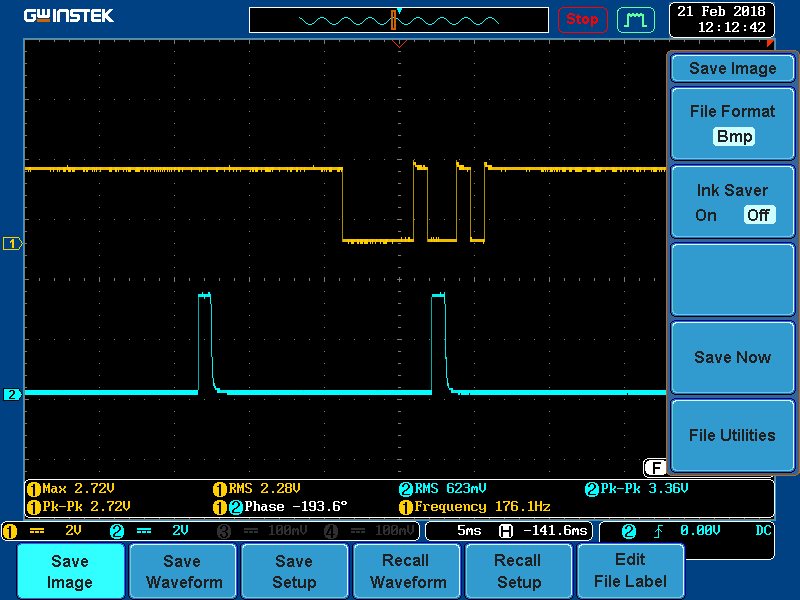

    i have found below scope capture when i run BSLDEMO2 tool
    Image 1 : yellow line is data received from controller which looks like 0xA0 (NCK)
    Blue line is data send from PC. as per code oF BSLDEMO.exe it will send 0X80(SYNC) for three times

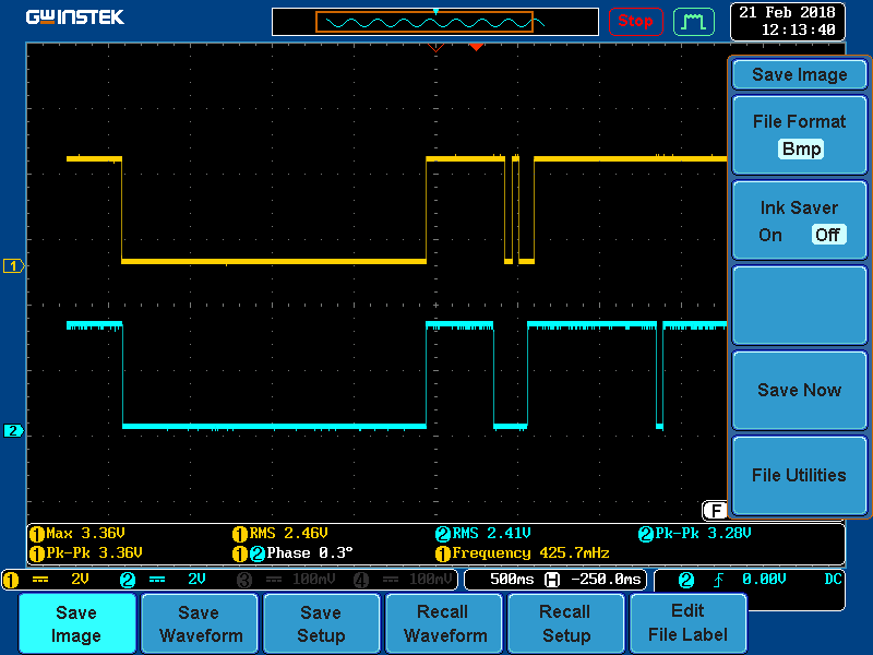

    Image 2 : Yellow line is going to TCK pin of microcontroller ( for msp430f149 series TEST pin is TCK )
    Blue line is RST pin of controller

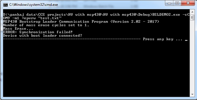

    here i think that signaling is proper but i don't receive 0X90(ACK) and so that BSLDEMO.exe gives synchronization error.
    below is image of ERROR
    Please suggest a solution....
