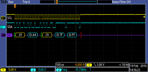

Replacing the TCS34725 by my prototype ‘430 Slave, the same ‘430 Master instead sees the following; note I2C data bytes of 0x7F, 0xFF:

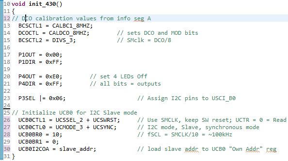

Slave Code is as follows (have tried several variations), and I must be missing some detail in the transition from Receive mode to Transmit mode:
Initialization, in “init_430” file, is:

Note that lines 29 & 33 of this Slave code tries to send data of 0x55 and 0xAA, while ‘scope shows 0x7F, 0xFF.

    but reading from Slave '430 shows data of 0x7F 0xFF:
    Slave's initialization code:

    One thing to check: please try clearing the USCI SW reset before you enable interrupts.
    Additionally, please make sure that you do not need to make use of any USCI interrupts (your code currently doesn't include any). You can use the User's Guide and software examples on the product page for details. Specifically, please see example msp430x22x4_uscib0_i2c_05.c which is an I2C slave example.

    I'm not presently using interrupts (the "enable interrupts" was leftover from when I had timer A blinking an LED as a "heartbeat") - I've now removed the enable as well... I was avoiding the added complexity of interrupts as the processor has nothing else to do and this is not a minimal-power application.
    I have also added a short delay at the end of the loop to keep UCB0 reset before resuming operation. Neither change affects the results.
    I had reviewed the example projects some time ago but didn't see one that matches my need for the "command" byte that (later) will tell the Slave which bytes from a small array that the Master wants to read. Looking at those examples now (...UCB0_I2C_05.c, _11.c and _13.c), I note they're using UCSTPIFG and UCSTTIFG flags, so I'll work down that path for a while.
