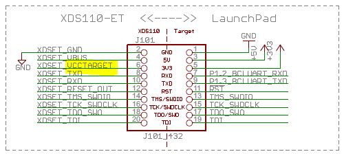

  • Vikram,
       The energy trace measures the current draw on the 3.3V pin on the XDS110 side of the launchpad.  On the XDS110 there is an MSP430 device which is counting the PWM pulses of the regulator and calculating the power/current.  Your target must be sourced from this rail in order to use the energy trace function.
    In other words, you would only connect pins 2 and 6 to the device under test.  I would recommend removing the battery and all other power sources from the DUT before applying 3.3V via the launchpad.
    Additionally, the JTAG connection should be removed as these pins will provide a leakage path back to the XDS110 processor and invalidate your current measurements.
    Please let me know if this is not clear.
    Chris
  • Hi Chris,
    Thank you for the reply.

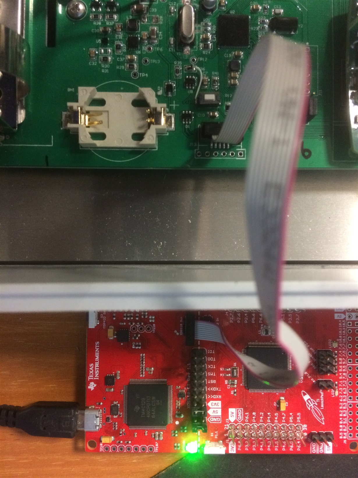

    So what you mean to say that I do not keep the 3.6V D cell battery mounted on the board use the VCC and GND of Launchpad to power 3.3V to the target board?
    So do I connect the jumper that is at GND and the VCC pins of J101 while powering the Launchpad and having it connected to debugger through JTAG?
    Since the msp432 MCU chip is on the target board and the only way to connect it to debugger is through the JTAG cable with one end of the cable connected to the taget board and the another end on the J102 side of Launchpad which is connected to the PC CCS debugger.
    Is the image below correct for connection?
    Please correct me if I am wrong.
    Thank you
    Vikram

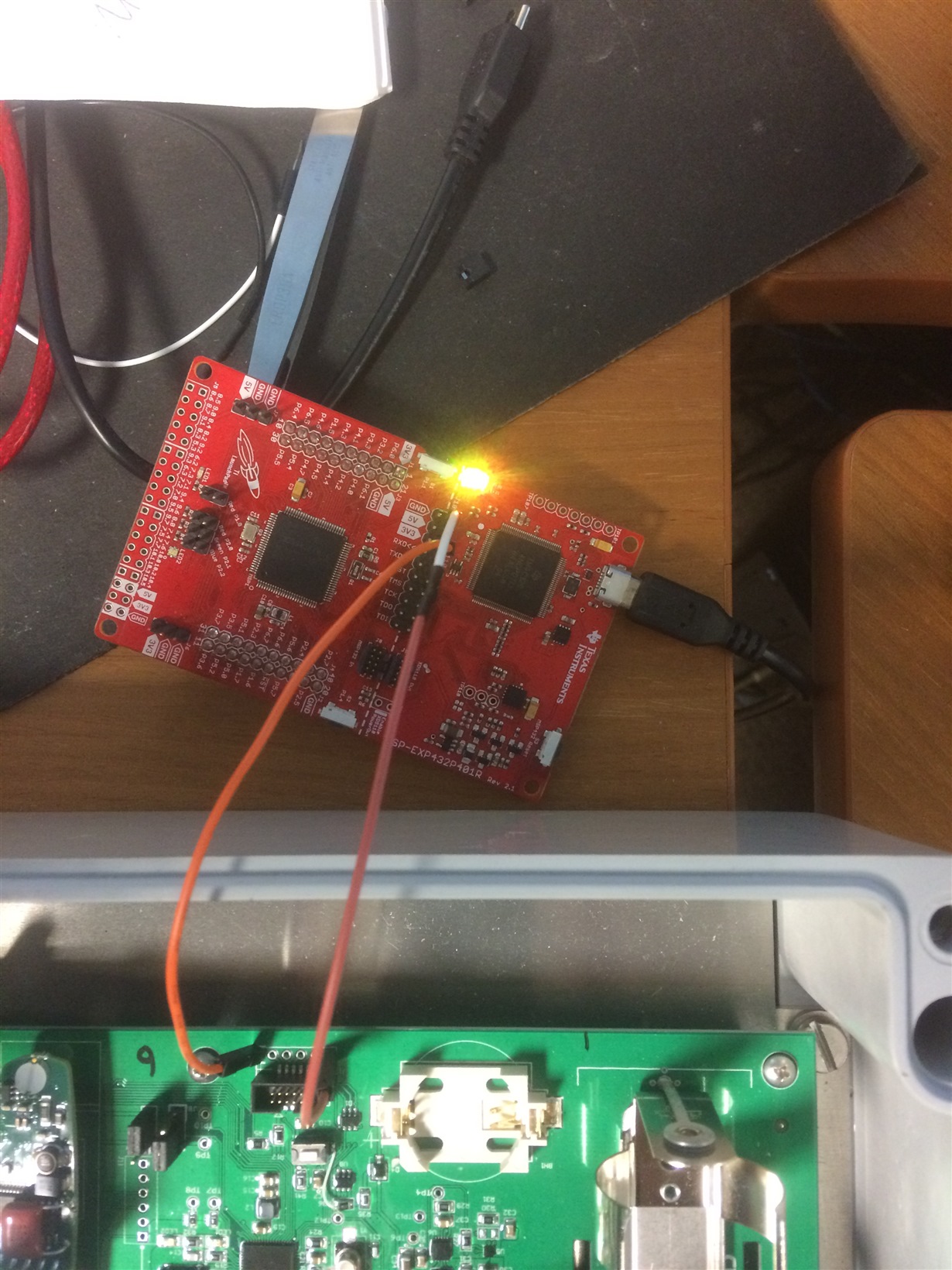

  • Ok I got what you were mentioning Chris.
    I used that approach. Below is the image for the set up.

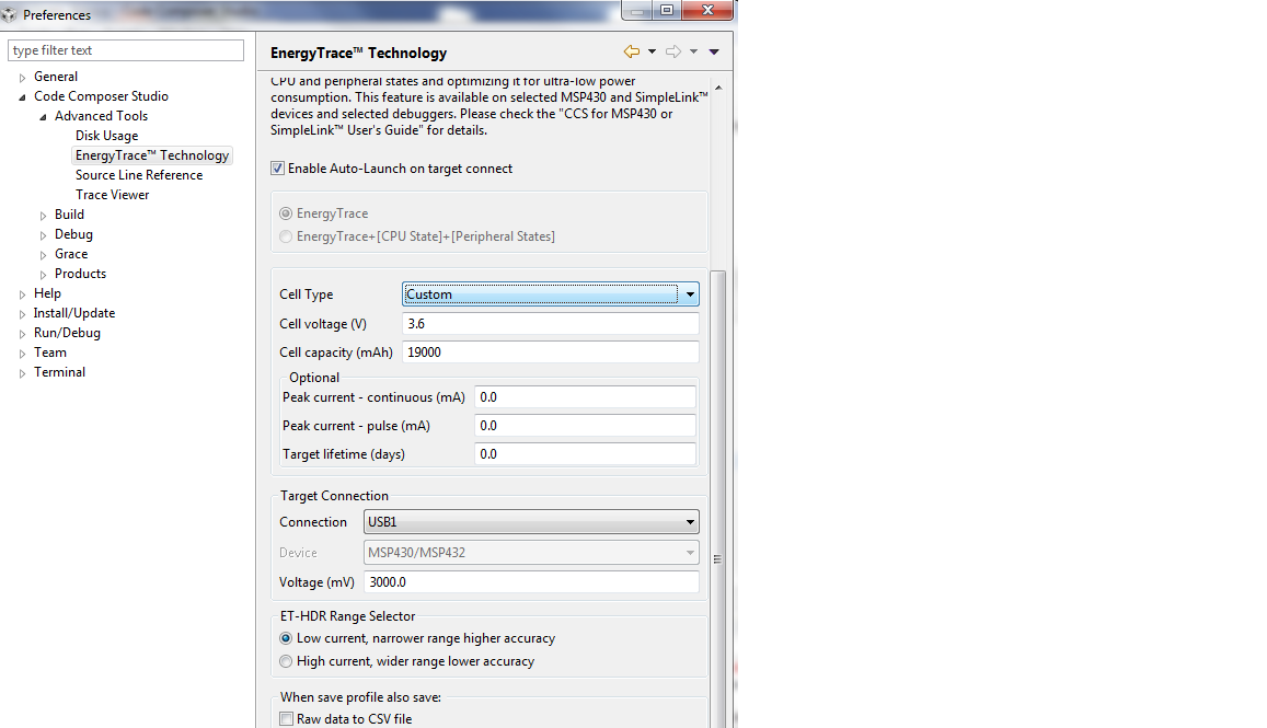

    But using this setup the minimum current that I am getting is 17.7319 mA which does not seem correct since using the multimeter in series across the battery and using the battery supply I am getting 2.36 mA in deep sleep mode.
    And the settings that I have used in the EnergyTrace window is as below.
    Can you suggest why this would be showing such a high value in deep sleep mode?
    Vikram
