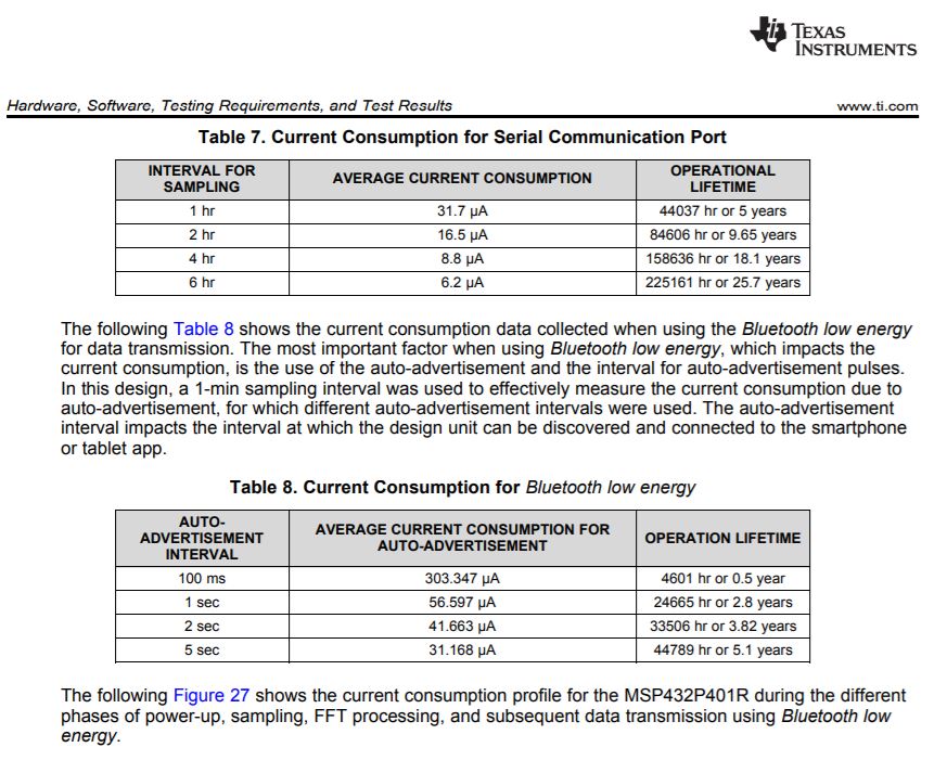

  • Vikram,
    Can you access the software associated with this design? In this implementation the WDT is used to wake up the MSP432P device from LPM3 (deep sleep 0). The interval is user defined and can range from seconds to hours. Please let me know if you cannot access or have questions.
    Chris
    www.ti.com/.../TIDA-01575

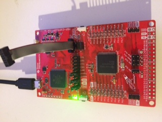

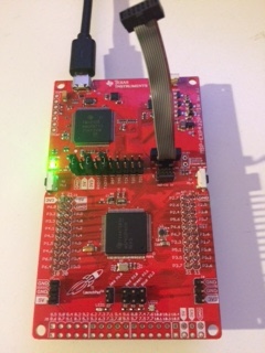

    I tried to check the current using the EnergyTrace Profile when the MCU goes into deepsleep as per the example provided and found the current in the deep sleep mode to be 2.9926 mA. Is that correct because as the documentations I see that the deep sleep current should be in microamps.
    Can you plesae confirm?
    Vikram
  •  Vikram,
       Are you running the serial communication example?  Yes I will confirm.
    Chris
  • Yes I am running the serial comunication example.
  • I was able to confirm the uA operation.  Is the debugger disconnected when you run energy trace?
  • Yes the debugger is connected. Otherwise how will I be able to see the Energy trace.
    Can you let me know he set up or share an image of the setup so that I don't have to connect to the debugger.
    Vikram

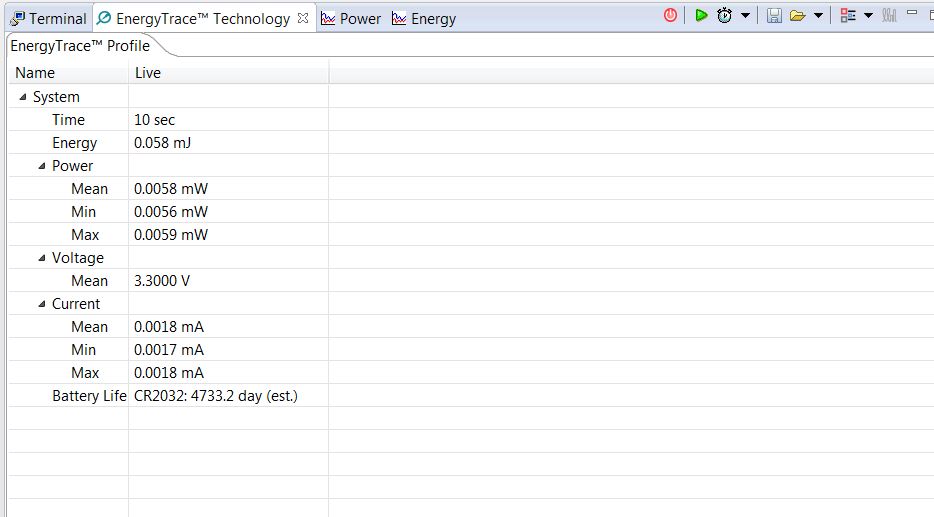

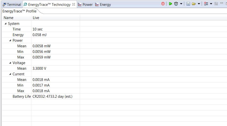

  • Thank you Chris for the document attached.
    So I see that if I run the board in the ET-only mode I get the mean current as 0.0018 mA, which resembles to your results.
    One more thing concerning is that when I execute the firmware related to the new SDK version that u had sent in the serial comm mode, I can see that the value of the sleep state changes to 2 (that is the value PowerMSP432_DEEPSLEEP_0) which is what was expected.
    But implementing the same concept of wake up through RTC in my firmware it still shows the value as 1 (PowerMSP432_SLEEP).
    Can't understand why is the same concept that is utilized in the firmware that you have sent not working in my firmware.
    Can you suggest some things that I can look into?
    Vikram

    I am trying to use the Energy Trace option but I am not sure what settings should I have while testing.
    Below is the image of the circuit connection to the debugger and I am using 3.6V D cell battery to power the board.
    Below is the image of the setting that I need to get idea based on the battery that I am using.
    Please can you guide on this so I can get idea about it.
    At present I tried the setting as shown in image below but that gives always 4mA whether active or in sleep which is not correct because in active mode I know it draws between 46-76 mA but with multimeter I am not able to go lower than 2.3 mA.
    So want to verify with that option too.
