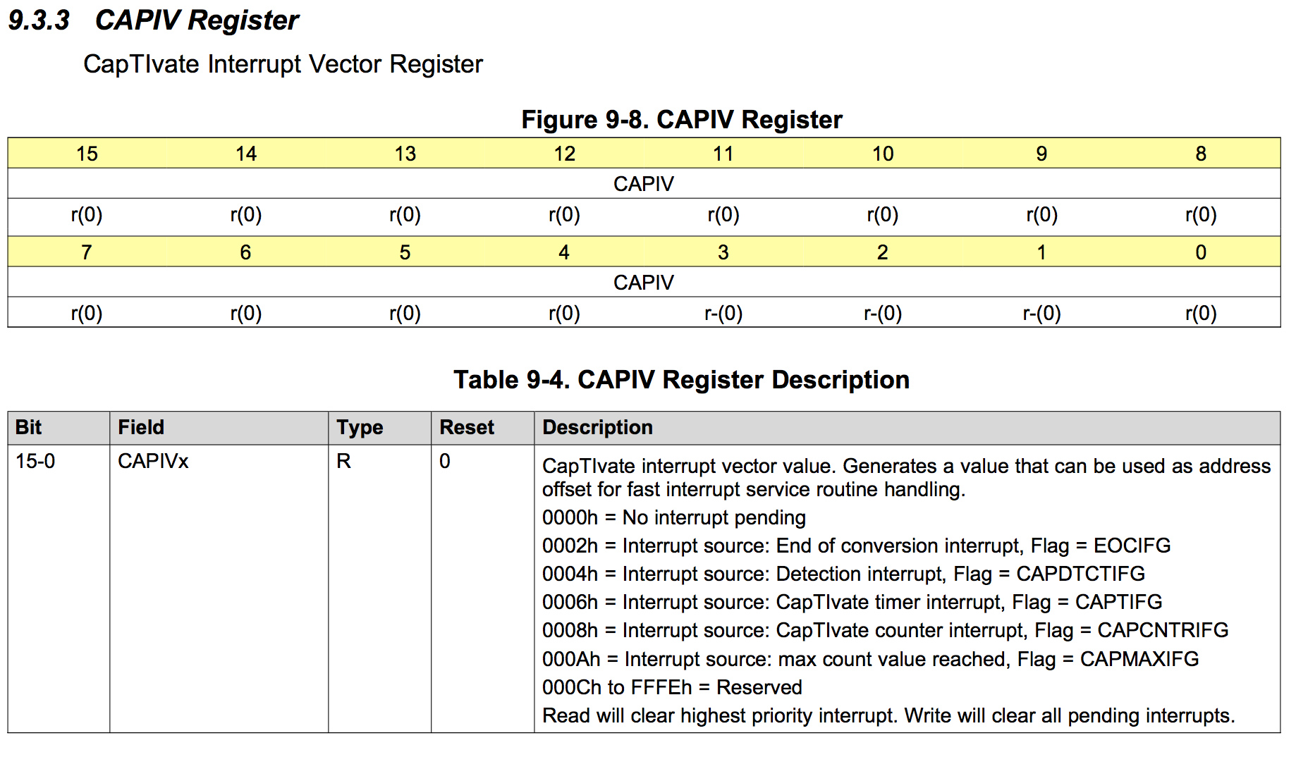

I found the MSP430FR4xx and MSP430FR2xx Family User's Guide, but in Chapter 9: CaptIvate Module, it only lists three registers: CAPIE, CAPIFG, and CAPIV. I am looking for the configuration/control register for this peripheral so I can understand its ADC capabilities.

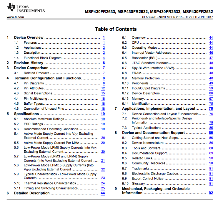

    The the Electrical Characteristics table for the CapTIvate periphera is in the msp430fr2633's datasheet which in www.ti.com/.../msp430fr2633.pdf in chapter 4.11.9
    For the the Register Map you can the msp430fr2633's datasheet in chapter 6.13.2.

    There is no chapter 4.11.9 in the msp430fr2633's datasheet. Chapter 4 only goes up to 4.6.
    Additionally, in chapter 6.13.2, it looks like this is the register map you are referring to:
    What I am looking for is a complete register listing for the CapTIvate peripheral. The User Guide only shows these registers: CAPIV, CAPIFG, CAPIE:
    Notice how the EOCIEN bit refers to a bit in a different register called EOCIFG. If you do a search through the PDF for "EOCIFG", the only result is on this page. If you go to the CapTIvate Design Center website and use the search box on the webpage to look for EOCIFG, the search returns no results.
    Please help me find the similar register listing for the CapTIvate registers, as well as a complete Electrical Characteristics table for the peripheral.
    I understand there is no "ADC" in the CapTIvate peripheral per se; capacitance is an analog quantity and it is converted into a digital quantity by the MCU.
  • I am sorry for the mistake.It should be 5.11.9.
    We just open the three registers: CAPIV, CAPIFG, CAPIE: for customer. Because it is a protected IP so far.
    You can't search the EOCIEN in the online user's guide is because the register description is save as a picture.(Sorry for that. You can find it in "Technology->The Captivate Peripheral->Auxiliary Digital Function") But it is same with the off-line version in pdf.
