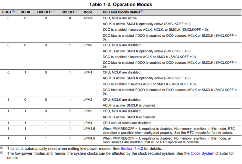

In the example code (msp430fr59xx_lpm3_03.c), I'm trying to switch from lpm3 to lpm0 using a timer. When I am trying to switch from LPM3 to LPM0, it's going to LPM1, instead of LPM0.
In the datasheet, it is mentioned that LPM1 and LPM2 are the two different variants of LPM0 itself.
It would be grateful if somebody clarifies the difference between the LPM modes.
