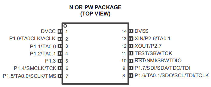

    looks like you will need to sit down with the documentation a little bit! Have a look at the pinout below:
    The device has 14-pin in total. Pin 1 and Pin 14 were the power supply pins, Pin 11 is not available for your application (for debugging only), and Pin 10 ist the Reset or NMI (non maskable interrupt) input (also used for debugging). This will give you a total of 10 availabe I/O.
    For your application you will need at least one input to the ADC (ADC10 means it has a resolution of 10bits) to measure your battery voltage resulting in 9 pins left for the LEDs. If you use the method described in the appnote you will only need 6 I/Os for driving 12 LEDs (instead of 12 when each one is connected individually).
