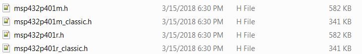

Yes, they are basically the same. The P1->DIR format follows the CMSIS standard from ARM, while the P1DIR |= is the 'classic' format used in MSP430. When you download the sdk you can see that there are two header files associated with the device and one of those has '_classic' in the name.
C:\ti\simplelink_msp432p4_sdk_2_10_00_14\source\ti\devices\msp432p4xx\inc
You will see that the newer devices (P401v,y,P411,P4x11) do not have classic alternatives.
