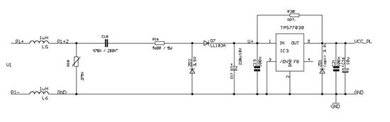

    in slaa203c, page 26. "power supply"
    is this circuit isolated from the line?
    No, it isn't. The GND is directly connected (only through an inductor) to P1-, which makes the virtual ground a real ground. It can only be used when the polarity of the measurement inputs is matched to N.
    You'll need to duplicate the 170nF/280V capacitor to the 'return' line too. Without it, it acts similar to a transformer, where one side of the output is wired to one of the input sides. Which still works as a tranfoermer, but isn't isolated anymore.
    Inthis supply type, teh combination of capacitor and resistor acts as a low-pass filter that dampens the input signal to a low voltage level. The output current consumption influences this low-pass too, so the choice of capacitor and resistor has to match the reauired output voltage and current consumption. If the current consumption changes, the output voltage changes too (hence the Z-Diode , which will swallow excess current and keep the voltage down.
    It is a very cheap but very inefficient type of power supply. And normally not isolating. (I don't know how the second capacitor influences the output too, but since these capacitors are usually big  - they have to be X2 type (a self-healing, failsafe construction) and higher currents require even larger ones - and expensive, and a second one increases not only costs but also size and energy loss, so a transformer might be the better choice again)

     this transil diodes can protect my circuit as soon as the fuse is broken.
    i am from Turkey. There are the companies pruducing the shunt resistor  in here. i have contacted with them.
    The burned msp430 is changed. and tried it. it is working normally. and i supply it by battery 9V.
    it works independent  both side of L/N, i tried. the result is OK.
    Now, İ am looking for isolated voltage regulator circuit without using transformer and using 220V L/N line.
    is there any suggest by you?
    You don't need to have an isolated supply, as long as the supply is directly fed by the same terminals the measurement L and N are connected to. So if L and N are switched, the supply is switched too and all is well. The capacitor supply will be fine. If should be, however, placed on the same PCB, so nobody can twist the connections.
    There are, however, several supply modules available which take 230V and output 3.3, 5 or 12V. It is a question of price, size and required load. These modules, however, usually provide much more current than you'll need.

    07. Is there any major difference in this circuit and a usual amplifier feeder circuit feeding two difference signals; apart from anti-aliasing circuitry?
    No.
    08. What are the "signals" to be seen on the two feeding points (IN+, IN- and IL+/IL-)?
    They are the protected and filtered differential analog signals connected to the ADC of the MSP430 chip.
    SHUNT specific:
    Why Shunts used in EM applications have three terminals?
    How would be the connections for a shunt in line (with reference to the said image, black, white & red wire terminals)?
    Black, white, & red are to be connected to AGND, LSP4 & LSP3 respectively.
  • Many thanks Mr. OCY.
    I should be implementing your suggestions immediately and posting the results here soon.
    --Utpal
  • old_cow_yellow said:
    03. AVCC & AGND:
    Are they generated from the SAME single phase supply?
    These are the power supply and ground of all the on-chip analog circuits. They must be connected to a power source off the chip; usually but not necessarily, the same as the source for DVCC and DGND.
    For best performance, it is recommended to put at least a low-pass filter (10 to 200 Ohms series resistor and 10µF Tantalum/100nF ceramic combo) between DVcc and AVcc. Also, AVss should be reoputed separately to GDN point of the supply, so currents on the digital GND won't create a ripplign analog GND reference.
    04. Can this circuit be tested with external power supply set to desired AVCC & AGND?
    Yes, but it must be between 1.8V and 3.6V, and DVCC & DGND must be at the same voltage.
    Well, almost the same. A variation of up to 0.2V is allowed (clamp diodes between DVcc/ss and AVcc/ss). This is enough to have a filtered, ripple-free version of DVcc on AVcc.
    Well, usually there are four terminals. The shunt you posted actually has five. The mounting holes are the terminals for the current path, while there are separate terminals for the voltage measurement.
    The reason is that the voltage teminals attach to the current path with the specified shunt resistance between them. If you'd measure at the mount holes instead, you had the additional contact resistance in addition to the shunt resistance, and would measure significantly more voltage - with an even changing factor.
    I guess, the 5th terminal allows for a current return and fixes one side of the shunt to (or near, which makes no difference as differential voltage over the shunt is measured) the circuit GND level, without causing an additional voltage drop on the voltage sense wires.
