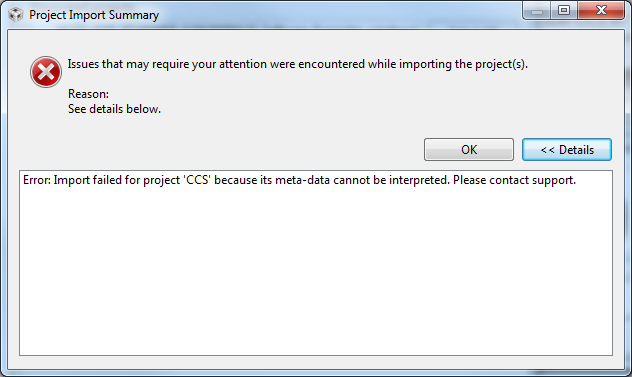

I have trouble with project for this develpment kit.
I have installed package of SW, CCS 7.3 with downloaded actualisations.
 How to correctly open Out-of-box project? I see this file only - OutOfBox_MSP430FR4133.projectspec with this content:

  • Hi Jiri,
    From within Code Composer Studio select from the top menu "Project>Import CCS Project" then navigate to the directory where the .projectspec file is located.
    Alternatively, select from the top menu "File>Import Projects from File system or Archive then point to the directory".
  • Hello, this is message, what I get when I am importing project.
    Jiri
  • Hi Jiri,
    Hmmm, I have CCS 7.4 and downloaded the out of box firmware and it imported no problem for me.
    I walked over to our software team that maintains the demos and they tried on their CCS 7.3 and it worked for them as well.
    Out of curiosity, did you install CCS 7.3 in a default directory or did you specify a custom directory?
    You might try checking for updates to 7.3 and apply them, or install 7.4 and give it a try.
  • Hi Dennis,
    I installed CCS 8.0.0. Situation was same as with previous version.
    I unpacked Out-of-box packake to different folder (c:\ instead c:\ti).
    Import of out-of-box project was imported without any problem.
    Thank you
    regards
    Jiri
