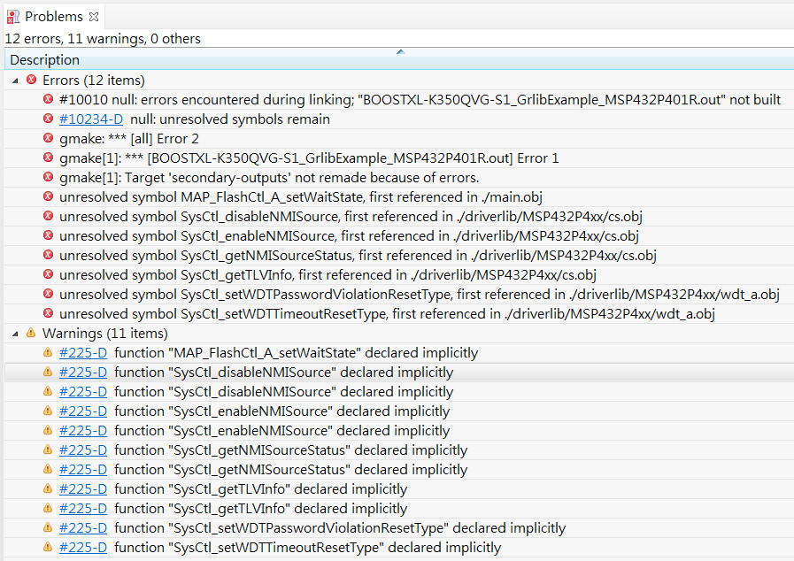

    Why the same changed of the project properties doesn't work for the other example project? For example, "BOOSTXL-K350QVG-S1_GrlibExample_MSP432P401R."
    Sunglin.

  • Hi Amit,
    I have cleaned the project and rebuilt it, but it still got errors.
    There are many undefined identifiers. The part of all error messages is attached.
    Sunglin.

  • Hello Sunglin,
    It seems that it is not taking the correct define. As I mentioned earlier, MSP432P4111 device use flash_a.c/.h
    The application should call the correct API and correct parameters and that is something you will need to do.

  • Hello Sunglin,
    The API for which the parameters are giving error is incorrect. The API's have an equivalent in the flash_a.c/.h and they need to be used along with the correct parameters.
  • Hi Amit,
    I copy flash_a.x and sysctl_a.x files to replace flash.x and sysctl.x, respectively.  Some definition variables have also been modified to correct ones. But it still gets some error messages which are listed in the following. Do you know how to solve this problem?
    Sunglin.
  • Hi Amit,
    I change all SysCtl_xxxxxxx functions to SysCtl_A_xxxxxxx, and it works now. I just follow your instructions that you reply before. Thank you.
