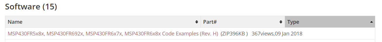

Working with MSP-EXP430FR6989 kit. There is no exact I2C software example for this part. Working with Resource Explorer and imported to IDE (CCS7.2) eusci_b_i2c_ex4_masterTxSingle
