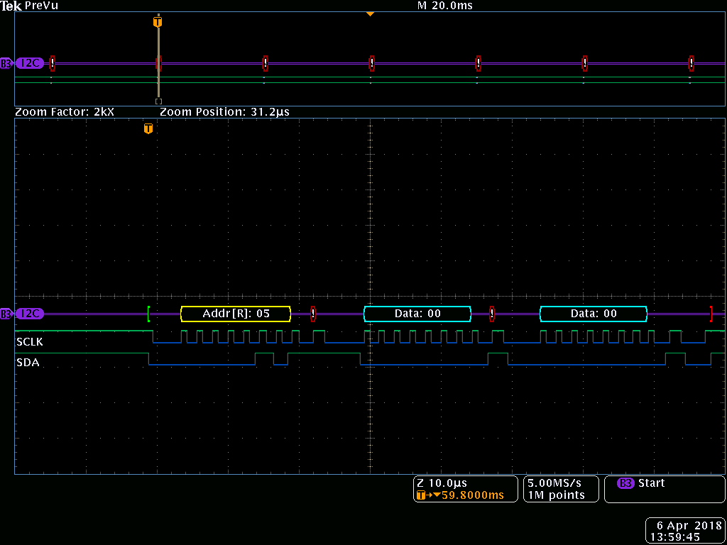

  •  Hi,
    I figured out that one and I tried with 0x05. That did not work and also i try the shifting 1 bit to the left and also that is not working.
    I am sending you this screen shot of capturing sequence.

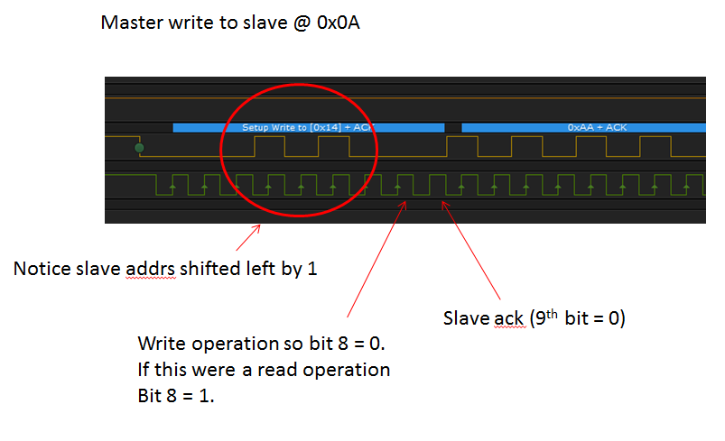

  • Parth,
    You indicated you are bit banging the MASTER I2C.  It doesn't appear you are shifting the slave address 0x0A << 1 and setting bit 8 = 0 (write operation).
    See example master write to MSP430FR2633 slave @ 0x0A below.
  •  Hi Dennis,
    I actually figured that out by sending the address 0x14 for the write operation so even if i shift to the left 1 bit, i will still send the address 0x0A with R/W bit = 0. Now with the write operation i can receive ackwnodlege back after the slave receive the proper address (0x0A).

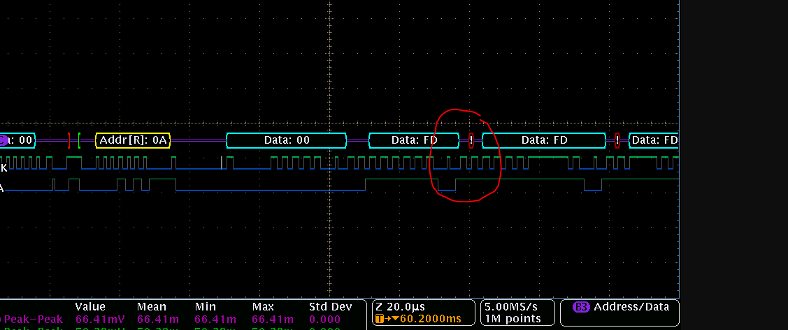

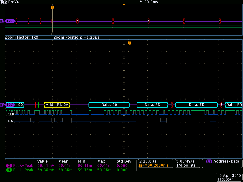

    Now I am able to 'write' in REGISTER I2C mode but when I tried to read with BSWP board, I am not able to get the 'Sensor Packet' properly.
    I am attaching the screenshot of the 'Read' command for the Sensor Packet. Please guide me.
    As per TI example, to read the Sesonr PAcket from the Slave, We need to write to Slave first, so I am sending [0x14]+[0x00]+[0x00] for demo- BSWP board 8 button group.
    No when I am sending [0x15] to read the sensor parameter back, I can not read the data back in proper format. As you knew already, we are not using dedicated I2C mode on Master, but we use bit banging technique.
    Please advice....
  • Hi Parth,
    My first thought is if you have the MSP430FR2633 programmed and running in the REGISTERI2C mode, then it should work.
    I did notice on your data capture that it appears the host is generating a NACK after the first byte, based on the SDA = 1 on the 9th clock bit.
    You might want to check this.  Also, try putting a little delay in between when you read each byte.  This will spread out the data capture and make it easier to see the clocks for each data and ACK/STOP etc.
