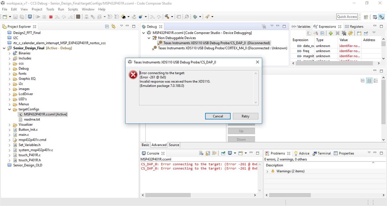

I have an external MSP432P401R on a PCB that I'm trying to program with the Launchpad XDS110 and I'm getting this error in CCS:
I followed all guidelines in the Launchpad manual section 2.3.4 Using the XDS110-ET Debug Probe With a Different Target

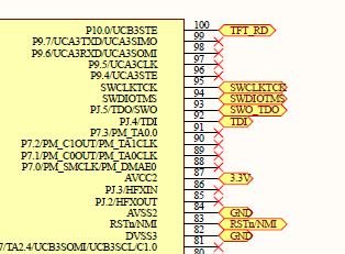

ALL jumpers were removed from J101. I have 5 wires going from the Launchpad XDS110 to my processor: TDI, TDO, TMS, TCK and RST.
I'm also supplying 3.3V and GND from my PCB, not from the Launchpad. I've confirmed that I have 3.3V at AVCC1, AVCC2, DVCC1 and DVCC2. I also confirmed that the proper pins are grounded: AVSS1, AVSS2, AVSS3, DVSS1, DVSS2 and DVSS3. I've triple checked that the pins are correct on my PCB for the programming circuit but I'll show them here:
I connected the 5 wires TDI, TDO, TCK, TMS and RST from the MSP432 to the pins listed above on the XDS110 J101 pins on the launchpad.
If it's worth noting, when I first tried to program to MSP432 it seemed to connect properly but when I hit PLAY to run the debugger it gave me error -1170 (I didn't get a screenshot). Every other time after that initial, I've gotten the error I listed initially in this post.
Any help is appreciated, is there anything you notice in my setup or any configuration change I may need to implement in CCS?

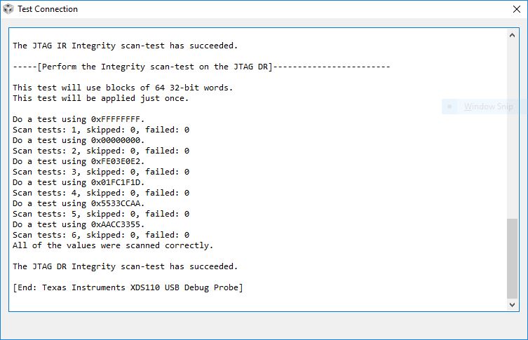

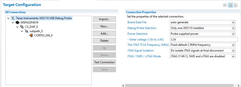

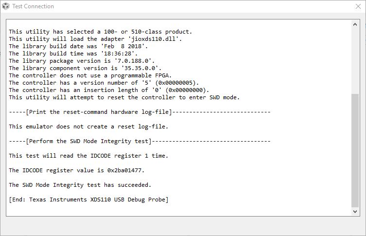

  • To help further debug, I tried powering my target PCB from the launchpad -- I put a jumper on the JP102 pins for "Enable XDS110 Power out" with the following settings in Target Configuration:
    I tried "SWD Mode - Target is TDO pin" as shown above with the following Test Connection results:
    I also tried to switch to "JTAG - SWD and cJTAG disabled" as shown below:
    And the following JTAG test connection results:
    Still having a connection issue with error -261 invalid response from XDS110.

    I tried to do a Reset by just building the project and then launching the configuration. When I selected "show all cores" shown below:
    When I right clicked on CS_DAP_0 and selected "connect to target" I again got this error:

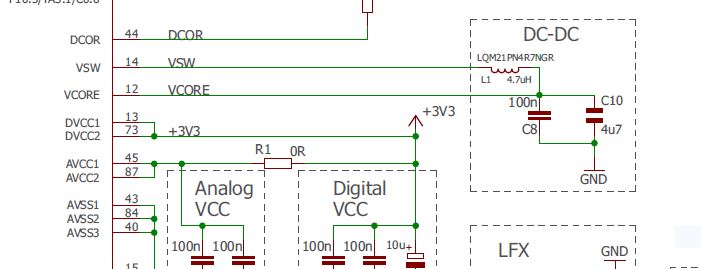

  • I'm almost positive I found the problem to all of this. I'm running the processor at 48MHz and am using
    PCM_setPowerState(PCM_AM_DCDC_VCORE1);
    PCM_setCoreVoltageLevel(PCM_VCORE1);
    Unfortunately on my PCB design I didn't have the DC-DC circuit between VCORE and VSW shown below
    So without this and trying to enable the DCDC converter, I believe it's causing a Power-on Reset from what I've read online. I'm going to add this circuit to my PCB to see if it fixes the problem.
  • Adding the VCORE/VSW DCDC converter circuit above fixed my problem.
    Thanks for the help!
  • Jacob,
    Definitely a problem- that inductor/capacitor circuit MUST be there for the DCDC to work properly, as you discovered.
