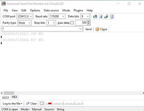

  •  Hi Bob,
    I connected 2 of the FTDI cables together with TX going to RX on each and get good ASCI going both ways.
    Connecting the MSP432 board up I can get 8 0 Hex or see the picture for ASCI
  • Michael,
    I am unclear if this issue is resolved. Were you able to get the communication working? If not, is your serial tool expecting MSB or LSB first?
    Chris
  • Thanks for the follow up Chris,
    I was not able to get it to work.  You can however close this.
    Regards, Mike
