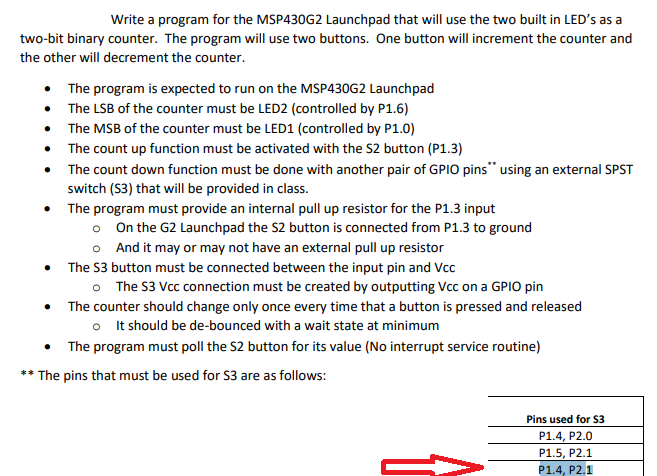

Hi all, I'm in need of a little assistance with a coding project I have going on. I have attached what I have so far along with the requirements needed.
As of this moment, only the "countup" function is working through the S2 Button on the launchpad. The connected third switch to P1.4 and P2.1 is not counting backwards through the LEDs as it should.
All help is greatly appreciated!!
