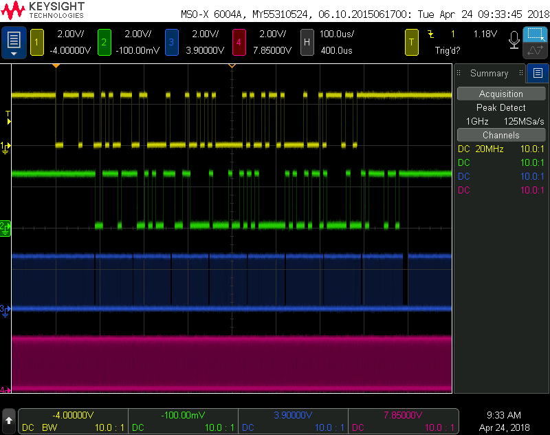

    With both of the "Enter Low Power Mode" lines commented-out, here's the result:
    What you can see is that received data is echoed back as transmitted data (by the ISR). The Blue trace ("Mainline running") has gaps where the UART ISR was active. (It's also got a bigger gap where the WDT ISR was active.) SMCLK was constantly active.

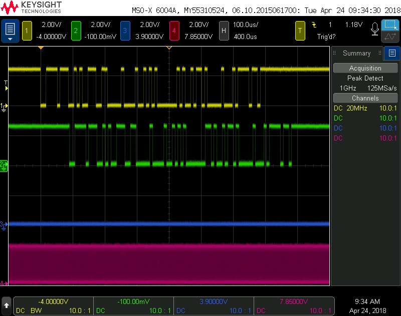

    With the "LPM0" line of my test program active, here's the 'scope trace:
    This is the same except "Mainline" never runs (no surprise here). Because it's just LPM0 and I haven't set SMCLKOFF, SMCLK is always active.

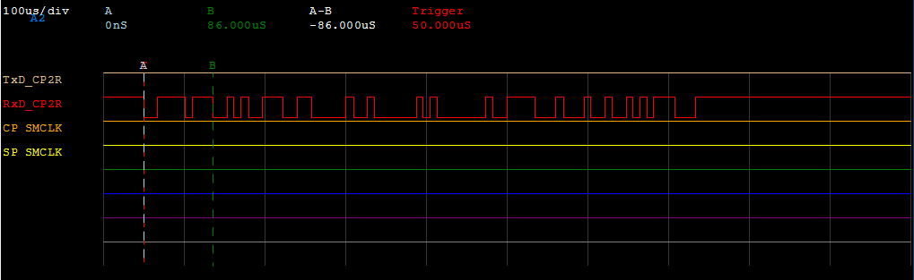

    When I send characters to my UART, here's what I get:
    (Note: I've got SMCLK from two processors being shown but we're only interested in "CP SMCLK")
    The "A" and "B" cursors delimit the first of my 115,200 b/s characters. You can see that SMCLK doesn't get rolling within the eight characters that I sent in (for this example).

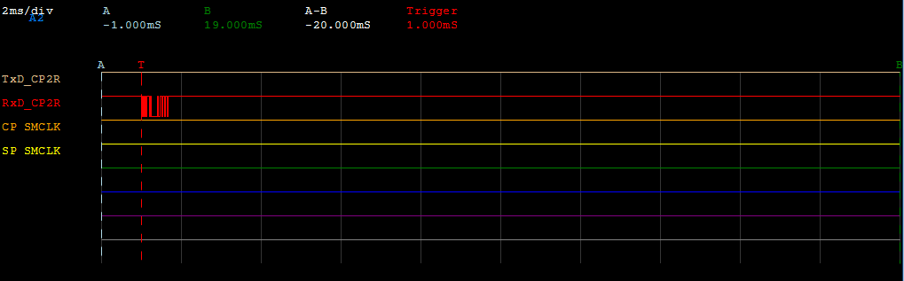

    Here's a longer view of the same test:
    In this case, we can see that SMCLK doesn't run even after 19 milliseconds.
    I'll experiment with a few more settings of the various SVS bits but I think I'm still stuck.
