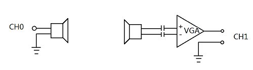

    I test the project named 'USSSWLIB_template_example' on EVM and my board, they have the same problem.
    The signal is so weak that the amplifiers inside the MCU are not enough to magnify it to the right intensity.So I have to add a  VGA board to amplify the tiny signals,and this board have no channel switching circuit,so I can  make a test for only ch0.

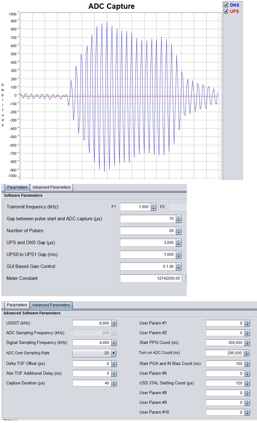

    I modify the demo GUI project from sequence_ch0_ch1 to ch0,and sample frequency is 3600,in the picture above you can see the GUI adc capture on the left,the real shape on the right,and GUI can't get the TOF.
    and this is the pictrue of sample frequency 4000,at this time, adc capture on the left, TOF display from GUI on the right.but you can see the data has a big wobble.
    If I use the unmodified project of GUI_demo,I can get the adc capture waveform looks right, the picture can be seen in my last post.at that time ,the TOF data can't be  obtained.
    Is it that my magnify the waveform signal-to-noise ratio is not good enough?
    or my configuration is wrong somewhere?

    Sorry for the delay. In your capture with 3600kHz sampling, the signal is too large. Please reduce the gain to get the ADC counts down to +/-900 counts. Let me know if that changes the TOF behavior.
