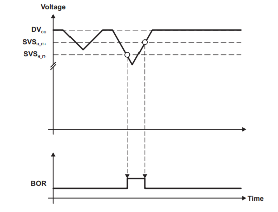

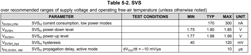

    Based on the SVS diagram and voltage table:
    If the supply voltage goes lower than VSVSH- the device will be in brownout reset until it reaches VSVSH+.
    And in your system, the supply voltage can be below VSVSH-.
