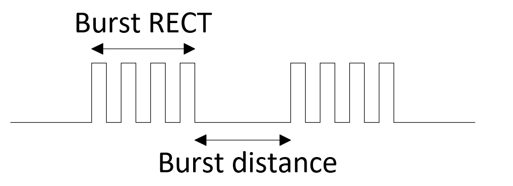

    i want to use PWM Timer from MSP432 to generate Bursts like this:
    Can the PWM Timer driver from MSP432 do this? If not, is there a way that MSP432 can do this?
    And if the MSp432 cannot do this, is there a IC from TI that can do Burst Signals?

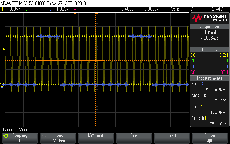

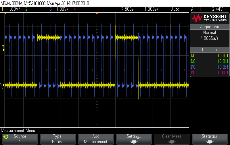

    I am using two timers TIMER_A0_BASE and TIMER_A1_BASE and output separately on GPIO pins to measure and understand it with an oscilloscope.
    I am using driverlib to generate the PWM.
    Yellow: 4MHz PWM Signal
    Blue: Gate and Timing controll
    The only problem is that the are not synchronized. And how do i mixed now this two signals with one timer?

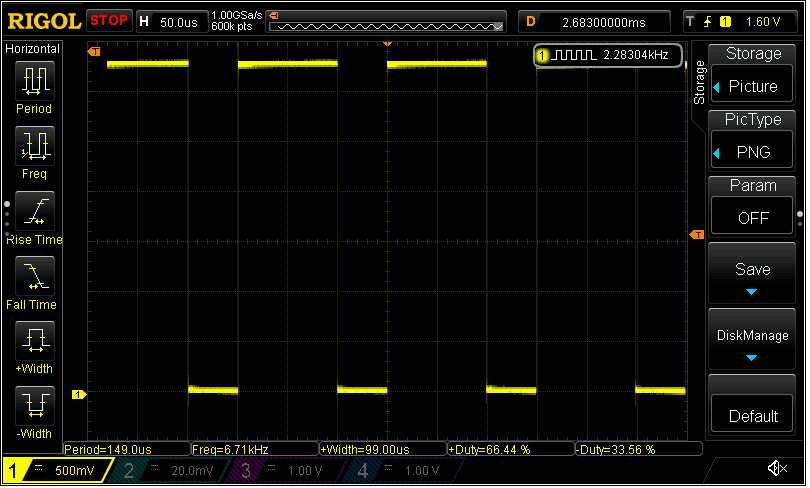

  • Ok, super-quick and super-dirty example from me.
    Main idea: we use CCR0 and CCR1 ISRs, timer in up mode
    1) CCR0 is used for Rect Time and Distance Time. While we are within Distance Time we don't output any PWM, we assure that by setting CCR1 to CCR0 + 1 (so that CCR1 interrupt never hits)
    2) When we switch to Rect Time (timer overflows) we start the burst by changing CCR1 value to PWM time, and then chaging On/Off times inside the CCR1 ISR until wi hit CCR0 once more.
     * We assume SMCLK as a source ~ 3MHz hence
     * sample = 1/3MHz = 333 nSec
     * PWM On Time = 300 * sample = 100 uSec;
     * PWM Off Time = 150 * sample = 50 uSec
     * And PWM Period = 150uSec, Duty = 66.6%
     * Rect time = 3000 * sample = 1 mSec
     * Distance = 6000 * sample = 2 mSec

    First pic: bursts (1 mSec resolution), second pic: PWM itself (50 uSec resolution).
    Keep in mind that this is not very reliable: dynamically adjust PWM within ISR.

  • Hi Andrei,
    i made some modification but still couldnt get it to work without interrupt but with external AND.
    To make sure the 2 timers are synchron, i use the TIMER_A1_BASE(4MHz) as "burst rectangle" generator and wire this externally as input clock for TIMER_A0_BASE.
    TIMER_A0_BASE generates also a PWM but uses TIMER_A1_BASE as clock and here i know that i am synchron. Both need to go to the AND logic IC and TIMER_A0_BASE controlls the burst time and distance.
    This code doesnt need the CPU to do any ISR to change counter and so on.
    Here is my code:
