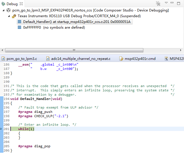

1. The program goes to an unexpected address, and CCS shows the following error:
and the "no source available" address is not the same from different tries. Some other address, such as 0x2260e4, 0x150d8c, may appear.
2. The program stops in the CPU_wfi() function in driverlib.c. As I resume the program running, it will get the breakpoint at the "while(1)" line, but if I continue to run the program, there will always be a disconnection from the debugger with the following error:

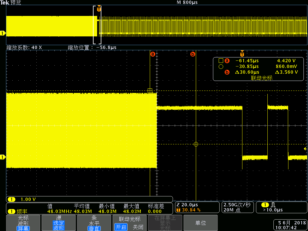

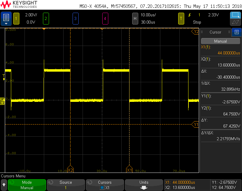

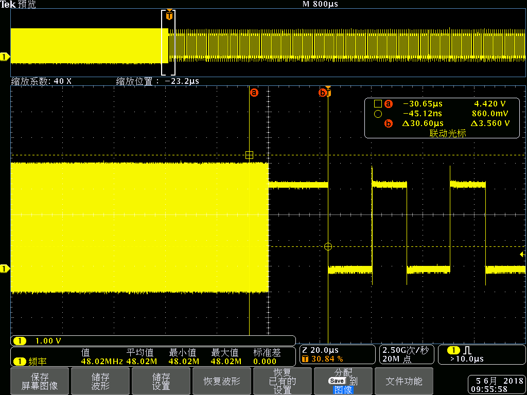

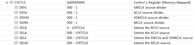

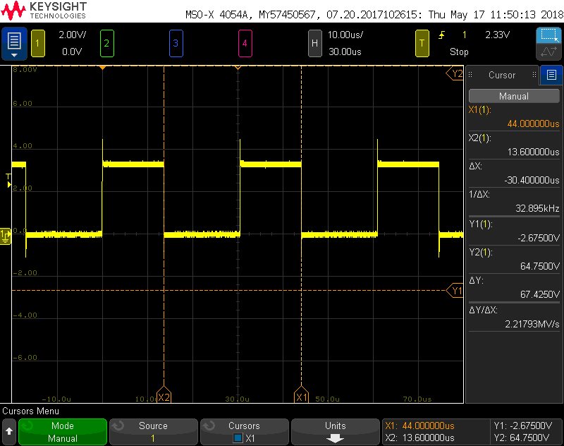

  • I have examined the clock as you suggested. I make the P4.3 to output MCLK, set a breakpoint after the HFXT to LFXT lines, and measure the MCLK with an oscilloscope. The frequency is 32.768KHz as expected.
    Also, I check the Register CS->CSCTL1 from CCS, and the setup is right.

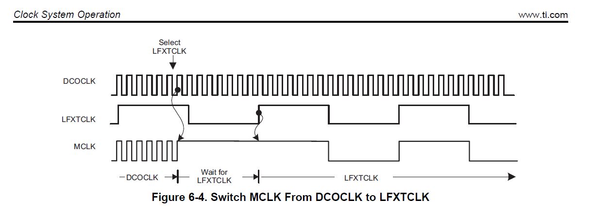

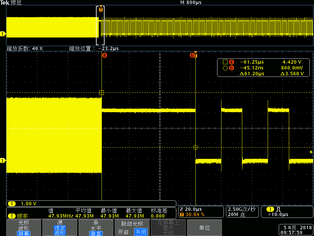

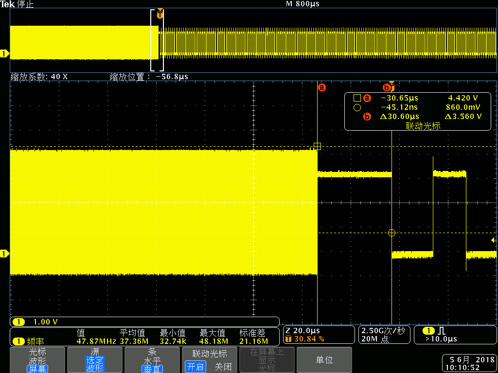

    I reprogram my board with the "pcm_go_to_lpm3" example code changing P1.1 TO P5.3 and P1.0 to P5.4 as P5.3 connects to the pushbutton and P5.4 connects to the LED on my board. It works well.

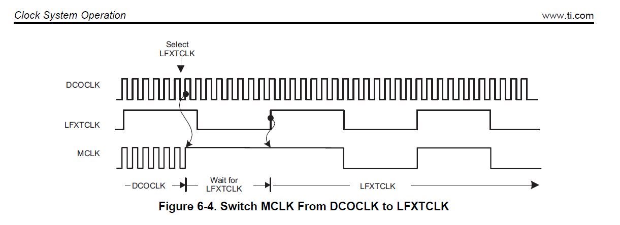

    However, if I add some lines to start the HFXT and set MCLK as LFXT as follows
        MAP_CS_setExternalClockSourceFrequency(32000,48000000);
        MAP_GPIO_setAsPeripheralModuleFunctionOutputPin(GPIO_PORT_PJ,
                GPIO_PIN0 | GPIO_PIN1 | GPIO_PIN2 | GPIO_PIN3, GPIO_PRIMARY_MODULE_FUNCTION);
        MAP_PCM_setCoreVoltageLevel(PCM_VCORE1);     // start HFXT
        MAP_CS_startHFXT(false);
    /* Setting LFXT to lowest drive strength and current consumption */
        MAP_CS_startLFXT(CS_LFXT_DRIVE3);
        MAP_CS_initClockSignal(CS_MCLK, CS_LFXTCLK_SELECT, CS_CLOCK_DIVIDER_1);  // set MCLK = LFXT
        MAP_CS_initClockSignal(CS_ACLK, CS_LFXTCLK_SELECT, CS_CLOCK_DIVIDER_1);
        MAP_CS_initClockSignal(CS_BCLK, CS_LFXTCLK_SELECT, CS_CLOCK_DIVIDER_1);
    the code goes wrong again. It will trapped in the Default_Handler
    If I comment the MAP_CS_initClockSignal(CS_MCLK, CS_LFXTCLK_SELECT, CS_CLOCK_DIVIDER_1);  line, not setting MCLK as LFXT, the code goes well. It seems that MCLK cannot be set to LFXT if HFXT is running.
    I also don't set MCLK to LFXT before entering LPM3, keeping it source from HFXT. The code can also work well.
  • While the above code , starting HFXT and configuring MCLK sourcing from LFXT, is used, I have exported all the  register values from a normal board and the problematic board, which are named as normal.txt and abnormal.txt.

  • Thank you for providing the additional information.   I am looking into this transition you have described which is also found in the trm (SLAU356).
    Please double confirm that this issue happens on only 2 devices out of the 400 that you have.
    Chris
  • I'm sure that only a few devices have this problem. The ratio is 4 out of about 600 now, as the problem happens to 2 more devices. I will check the transition from HFXT and LFXT with an oscilloscope later.
  • 6.2.12 in SLAU356 gives the following description:
    • The current clock cycle continues until the next rising edge.
    • The clock remains high until the next rising edge of the new clock.
    • The new clock source is selected and continues with a full high period.
    I observe the MCLK with an oscilloscope,  while it switches from HFXT to LFXT.
    1. For the problematic device, I get two pictures
    In the first picture, MCLK remains high until the first rising edge of the new clock(LFXT) and continues with a full high period. But in the second one, MCLK remains high until the second rising edge of LFXT and continues with a full high period.
    2. For the normal device, I also get two pictures
    I haven't found any obvious difference from the abnormal device. The MCLK also sometimes remains high until the second rising edge of LFXT.
