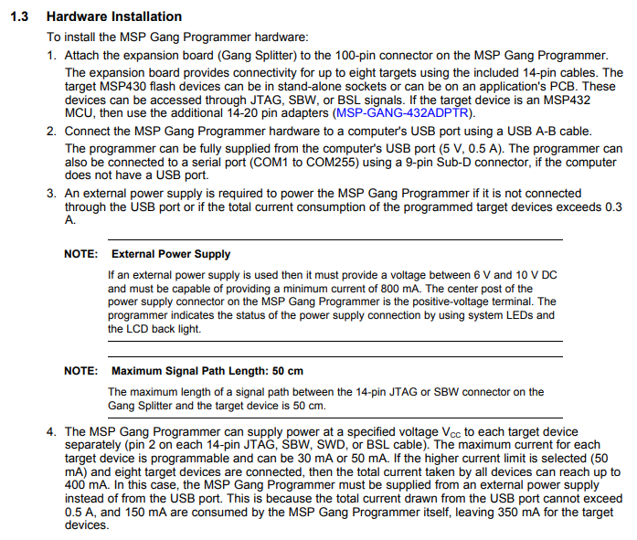

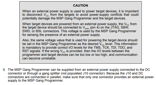

MSP Gang is failed during programing PCBA(PCBA is powered by MSP GANG, no external power ) and showed 'Vcc is too low" on screen. PCBA can be reprogramed by change a new MSP GANG programmer.
Sleftest found errors as below report, and the MSP GANG programmer is damaged during programing. Please help to identify why it's damaged, what's the possible roortcause? thanks.

21: Vcc Target-1 (ALL OFF) 0.00 V ( 0.00 to 0.30) Result: 1.59 V ... >> ERROR <<
22: Vcc Target-2 (ALL OFF) 0.00 V ( 0.00 to 0.30) Result: 3.02 V ... >> ERROR <<

36: Vcc Target-1 (ALL ON 1.8V) 1.80 V ( 1.60 to 2.00) Result: 1.60 V ... >> ERROR <<
37: Vcc Target-2 (ALL ON 1.8V) 1.80 V ( 1.60 to 2.00) Result: 3.07 V ... >> ERROR <<

44: Vcc Target-1 (ALL ON 2.7V) 2.70 V ( 2.50 to 2.90) Result: 1.60 V ... >> ERROR <<
45: Vcc Target-2 (ALL ON 2.7V) 2.70 V ( 2.50 to 2.90) Result: 3.06 V ... >> ERROR <<

    Please carefully read through Section 1.3 Hardware Installation in the MSP Gang Programmer (MSP-GANG) User's Guide and make sure you're following the recommendations, such as not using cables longer than 50 cm.
    The MSP-GANG could be damaged. Was anything violated in the warning below? Please confirm.

  • Was there a short on PCBA when you programmed it with this MSP-GANG? Are you supplying voltage on PCBA on Pin 2 that would conflict with the supply voltage from the MSP-GANG? What cables are you using to make the connections? Are they the cables that came with the MSP-GANG? Is there a chance that you didn't make the connections correctly on Connector 1? What level of current were you providing through each connector from the MSP-GANG? If a new MSP-GANG works well, then perhaps this issue gets caused over time (such as sourcing more current than recommended). You can refer to the schematic in the MSP Gang Programmer (MSP-GANG) User's Guide for more details on the circuitry for each connector.

    Thanks for the additional details. Everything seems fine here, so if you're confident none of the warnings/recommendations weren't violated, I'm not sure what happened. According to the schematic, there are current limiters (not sure if these are specific ICs or just current-limiting resistors) for each supply. Refer to page 129 in the MSP Gang Programmer (MSP-GANG) User's Guide.
    Regarding the max 30mA setting, this ensures that the max eight target devices do NOT exceed 0.3A. Eight targets at 30mA each equals roughly 240mA or 0.24A. Keep in mind that the MSP-GANG itself consumes another 0.15A. Thus, the total is approaching 0.5A or 500mA which is the max current that can be supplied over USB. If you keep eight targets and change the supply current setting from 30mA to 50mA, you'll be exceeding 0.5A total (0.4A plus 0.15A equals 0.55A) - this would require an external power supply instead.
    Did you measure the average power consumption of each target? You can use the schematic in the MSP Gang Programmer (MSP-GANG) User's Guide to debug the issue to perhaps a failed component, shorted passive, etc., but otherwise, I'm not sure how much more I can help you with this issue.

    By "MSP be damaged", I'm assuming that you're meaning the MSP-GANG. If you're not following the recommended guidelines for the supply current (including inrush current, static supply current, etc.) then I would not be surprised if the MSP-GANG quits working. It may not happen immediately, but perhaps over time exceeding the recommendations causes damage to the MSP-GANG.
    Moving forward, please ensure your target devices aren't exceeding the current recommendations for the MSP-GANG.
