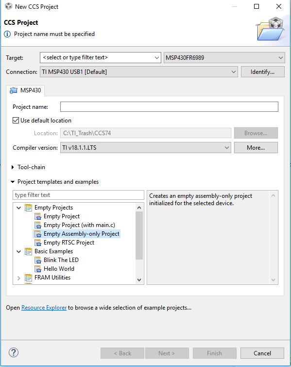

  • Kip,
    I got it working.
    Looks to me that CCS generates wounded makefile.
    Compiler does not obtain --entry_point=RESET directive and fails during an out image creation.
    .cproject should contain something like this:
    Line 85: <option id="com.ti.ccstudio.buildDefinitions.MSP430_18.1.linkerID.ENTRY_POINT.207217953" name="Specify program entry point for the output module (--entry_point, -e)" superClass="com.ti.ccstudio.buildDefinitions.MSP430_18.1.linkerID.ENTRY_POINT" useByScannerDiscovery="false" value="RESET" valueType="string"/>
    Line 184: <option id="com.ti.ccstudio.buildDefinitions.MSP430_18.1.linkerID.ENTRY_POINT.358972097" name="Specify program entry point for the output module (--entry_point, -e)" superClass="com.ti.ccstudio.buildDefinitions.MSP430_18.1.linkerID.ENTRY_POINT" useByScannerDiscovery="false" value="RESET" valueType="string"/>
    To get your assembly examples working do like this:
    1) create a new empty assembly project with a name similar to the original
    2) in main.asm delete all content and copy all content from the original assembly file
    Should pass compilation and work. At least msp430fr69xx_1.asm example.
    Some examples may not work because the empty assembly project has stack and heap size = 0 by default.
    Try to install CCS v8 or v7.4.
    You should not have problems installing v8.
  • Tomasz, You have been hard at work it looks like. I have CCS V8 When I create a new empty project, it defaults
    to a C project. Don't know if this will work or not. I will try your suggestions. You have done your best and
    thank you for all your work. We all learn from these challenges I guess.
  • Kip,
    find above where to select a project template.
