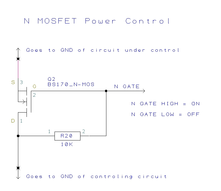

    Probably the most robust solution is to gate a card with an N-MOS transistor driven by one of GPIOs.

  • Thanks to google and someone who did the job:

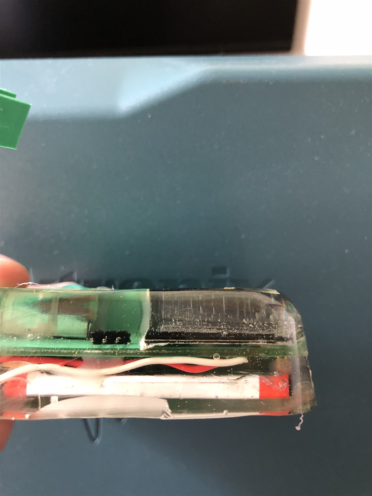

    I have different cards but I would like to use a sandisc in the production. The 250uA would be perfect because right now I've got stack at 30mA consumption. I have also a tiny solar panel on the board and it charges the battery really well.

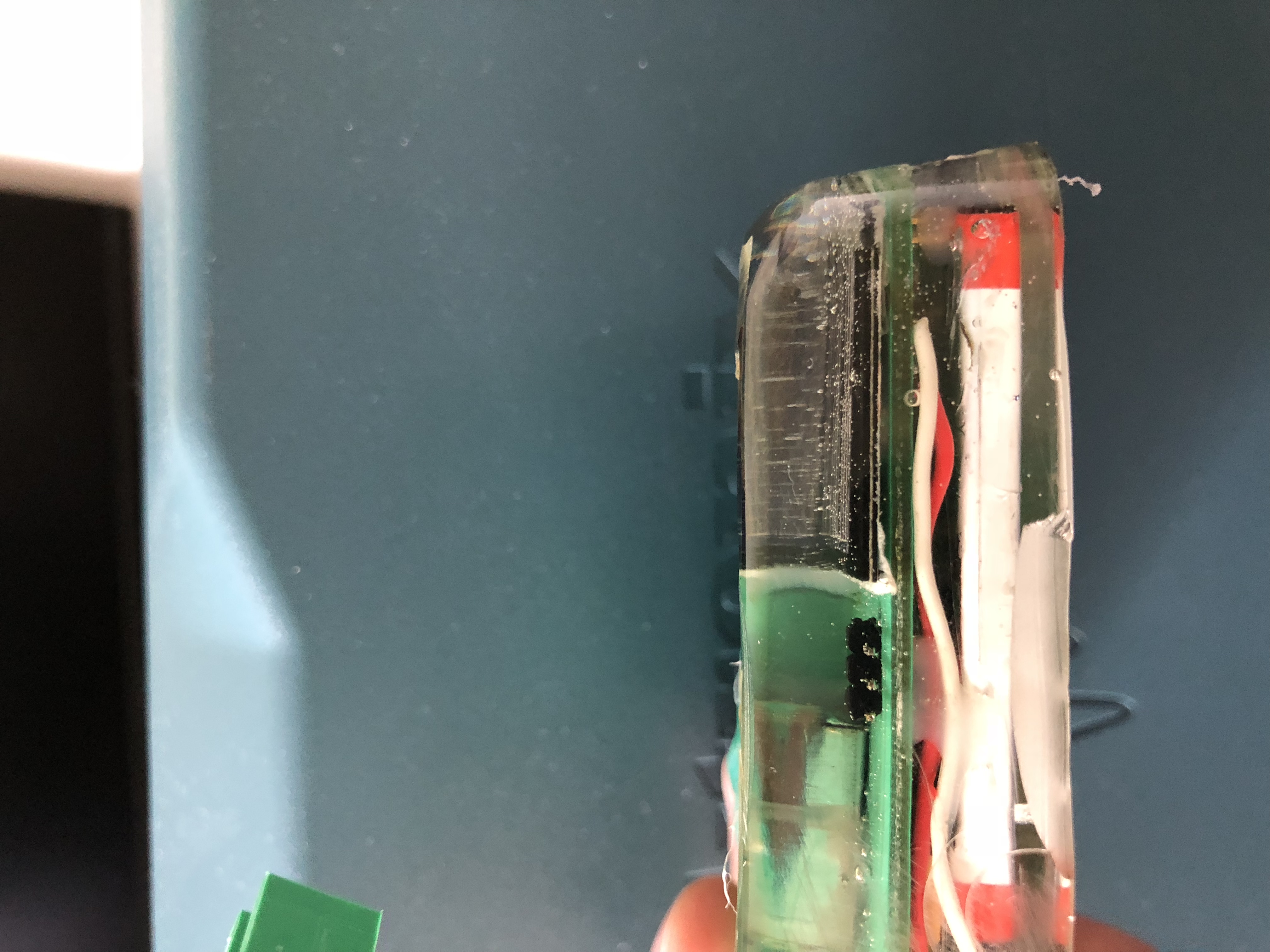

    The main problem is that I already put the PCB in the preproduction phase(for testing few board) and I cannot access the SD card anymore to replace it.
    Right now I would like to save the 10PCBs that are ready to go in the production, later on I will switch to spi ram or put an switch for the SD.
    So if you are so kind to let me know how can I shoot down the SD card I would be really grateful.
    I'm attaching an image of an test board(not the current one) and the case... so you can see why I cannot change the SD card :D
    Thank you for the help
  • Thank you for the picture and idea.
