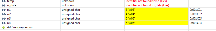

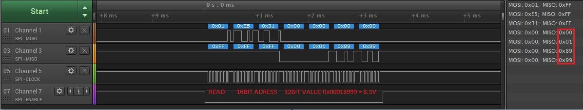

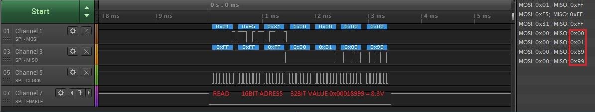

  • Hello Dennis, thanks a lot for your message!
    My launchpad is connected to the ADE7878 evaluation board, i have my logic analyzer connected in parallel  so i can see the data i'm sending from the MSP and the respond of the ADE7878. Thank you for your hint about the clock phase, i've checked it again and i think that its correct. Below is a short outtake from the datasheet:
    " A read operation using the SPI interface is initiated when the master sets the SS pin low...The master sends data on the MOSI line starting with the first high to low transition of SCLK. The SPI of the ADE7878A samples the data on the low to high transitions of SCLK...After the ADE7878A receive the last bit of the register address on a low to high transition of SCLK, it begins to transmit the register contents on the MISO line when the next SCLK high to low transition occurs; the master samples the data on a low to high SCLK transition. After the master receives the last bit, it sets the SS and SCLK lines high, and the communication ends.
    I see on my logic analyzer that the energymeter responds correctly, for example i perform a read operation on the 32bit register that represents the measured RMS Voltage and if i convert the obtained hex value i'm getting the voltage that i apply on the ADE7878 (8.3V). Below is the screenshot of the logic analyzer:
    And that's what i'm getting in my variable scope:
    Instead of getting 0x00 / 0x01 / 0x89 / 0x99 (is what i see in Logic Analyzer), i'm reading 0x00 / 0x01 / 0xFF / 0xFF.  I assume that i have some mistakes in my code. Since the writing part is functioning, i assume that the read function is not correct. My idea was to create a function SPI_8 that sends one byte and in the next step it saves the value of the RX buffer in the RXdata variable. Then i save this value in one of the global variables rx1...rx4. I've tried to perform the read operation over the ISR but since i'm new to embedded programming I'm not getting it working correctly. I would be very thankfull if you could look over it and tell me if something is wrong. Thanks a lot for your support and have a great weekend! (p.s. i will be able to reply on tuesday first)
    Below are the main parts of my code:

  • Hi Illya,
    I copied your code and programmed an MSP430FR5994 launchpad.
    I modified a couple of lines in your main loop:
       while(1)
           read(CONFIG2, 4);
           _delay_cycles(1000);
    The master writes the 3 bytes (0x01 and addrs 0xE5E1), followed by 4 dummy bytes.
    I then programmed a second MSP430FR5994 launchpad with SPI slave code that always responds with 7 bytes {0x00, 0x01, 0x02, 0x03, 0x04, 0x05,0x06} ( one for each byte received).
    Here is what I see on the SPI pins:
    I then checked the 4 bytes received in your code and it shows it captured them correctly.

    Set a break point just after the call (you can use a _no_operation() to set the break point on)
    read(CONFIG2, 4);
    _no_operation();
    After the call, examine your rx1, rx2, rx3, rx4. You should see the values you transmitted.
    I tried this and it works for me.
  • Hello Dennis!
    thank you for your reply! I've tried it before and it is working for me aswell. Thats why i'm wondering why i can't read the data from the IC, but i can receive the data while shorting MOSI and MISO. The data that is coming from IC looks very good on the scope - no noise, good timing, good voltage level.

  • Hello Dennis,
    i've found the problem and it's not due to the code. The metering IC is galvanically isolated from the MSP, if i connect the microcontroller directly to the ic, everything works fine. Now i'm trying to understand the reason for this behaviour. Do you have any ideas? Thanks a lot for your help!
    Kind regards
    Illya
