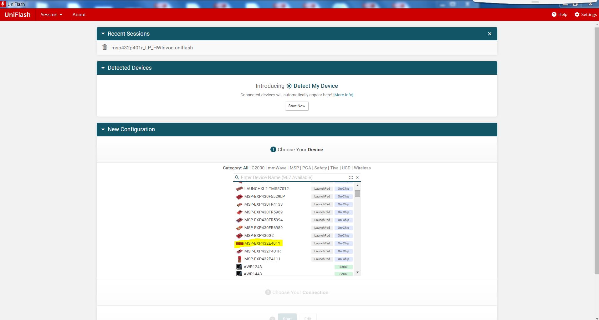

I have just begun using MSP-EXP432E401Y. I have installed its SDK and build example project "gpiointerrupt_MSP_EXP432E401Y_tirtos_ccs" using CCSv8.
Now I want to create image and program the board. But I can't find any tool to do do.
Also, Uniflash neither list MSP-EXP432E401Y or detect the device.
Please list the tool and procedure to program the device.
Vaishali.
You can create an image and download the program via CCS. Please refer to the CCS training here:
dev.ti.com/.../
Here is a screenshot from Uniflash
