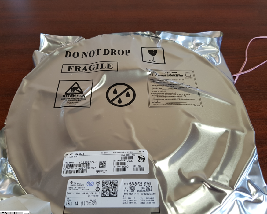

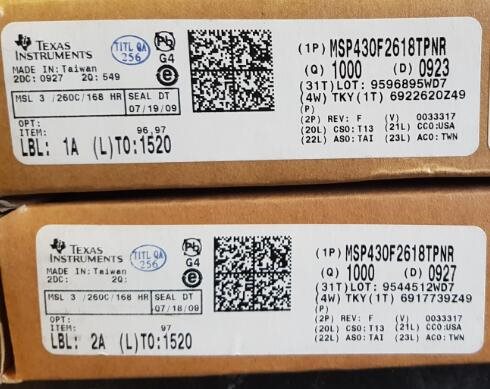

We have 600pcs MSP430F2618TPNR surface mount on our PCB under solder reflow, and we found there are about 20pcs MSP430F2618TPNR cracked.
I'm not sure what cause this. These MCUs is made at the year 2009, but the Moisture Barrier Dry Packing is good.
thank you for contacting TI regarding the issue you have seen after reflow of MSP430F2618TPNR.
From the picture it is hard to say what happened exactly to the device to show this type of cracking. It seems that the maximum soldering ratings are somehow exceeded or moisture was present in the devices.You may check whether the Humidity Indicator Card is showing moisture even if the moisture barrier bag was good. Moisture in the IC package can lead to pop corn effects during soldering.
Absolute Maximum Ratings for Soldering apply to the devices which are described in the application note: www.ti.com/.../snoa549d.pdf , or www.ti.com/.../snoa550e.pdf.
For further reference you may have a look as well to the "Plastic Package Moisture-Induced Cracking" application note.
