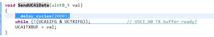

I'm still using the EXP_MSP430F5529LP development board to verify SPI communication, Recently , I'm stuck in the SPI_transfer() function. config spi slave mode under TI-RTOS.
target: SPI master sends a byte, spi slave  judge the byte and to continue receiving or sending data.
here is my config

result
When I using the spi master send three bytes at a time, code 1  receive data is ok,  buf code 1  will block in the second SPI_transfer();
When I using the spi master send three bytes each byte is one second apart,  code 1 2 receive data both is ok.
Why is this problem?
best wishes
xc.mo
  • There's a problem with my description.
    When I using the spi master send three bytes at a time, code 1 receive data is ok, buf code 2 will block in the second SPI_transfer();
  • issue 2.  When I using the spi master send two bytes at a time, and slave module use code 3  , why receive data is ok?
    When I using the spi master send three bytes at a time, and slave module use code 4  , why  block in the second SPI_transfer()?

  • Hi Cameron
    Thank you very much for your help, although I added a delay to spi master module to avoid the problem of spi slave block the SPI_transfer() function, I would like to know why.
