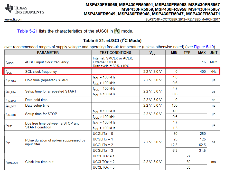

    I was also under the impression that the maximum I2C clock speed was 1/4 the MCLK frequency. Is this not true?
    Do you have a link to the documentation that mentions this?  Below is the datasheet specification that clarifys the maximum I2C SCL frequency.
    Walter
  • Quinn,
    I wanted to close back out with you again. I can confirm that the eUSCI does not support hardware zero-byte reads, so this would in fact be a limitation for you. I checked with another expert on the eUSCI_B just to be sure. Also, as mentioned above, the SCL limit is 400kHz.
