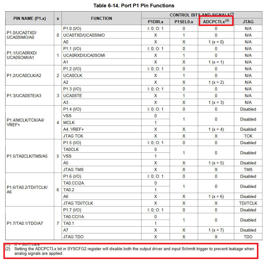

    EDIT: I think I may have found an error. While I have set specific ports in SYSCFG2, I did not select analog function in the P1SEL0 and P1SEL1 registers. When attempting to set 5,6 to their tertiary purpose of A5 and A6, I received the following error.  #20 identifier "PASEL1_L" is undefined main.c in reference to P1SEL1 |= BIT5 + BIT6;. The same line of code for P1SEL0 works just fine.
    The MSP430FR4133 does not have PxSEL1 registers; this is why you are getting the error.  Some devices have this register, but not all of them.  The MSP430FR4133 only has PxSEL0.  You only need to select ADCPCTLx.  Below is the documentation on this topic.
