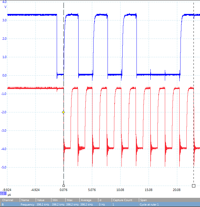

  • Blair Conner said:
    I'm trying to implement I2C communication and as the title states the ISR's are not running at all.
    Have you tried setting a breakpoint in the ISR? Have you checked the I2C lines with a logic analyzer? I see that you're enabling interrupts, so the ISRs should be working.
    James
    MSP Customer Applications
  • Hi James,
    I have placed breakpoints in the ISR's and they are never entered. I'm going to check the I2C lines with a logic analyzer this afternoon. Does anything look out of place with my code?
    Blair
  • Are you disabling your compiler optimizations when debugging? I didn't notice anything wrong at a high level (yet), but I must admit it's a little abstracted with all the variables/enums. I would encourage you to hard-code these (such as I2C_BASE_ADDRESS[port] in the functions) to rule them out. Are you enabling global interrupts using GIE? Please look through the code examples again to see if you're missing anything else.
    James
  • Hi James,
    All optimizations are off. Looking at the scope it looks like the address byte is sent out but I'm not getting an ACK.
    What is the interrupt vector I need to use to capture these errors? I can't find example code with it...
    Blair
  • I found the issue. I didn't need to shift my slave address. Looks like the driverlib handles that.
    USCI_B_I2C_setSlaveAddress(I2C_BASE_ADDRESS[port],slaveAddress << 1);
    should be....
    USCI_B_I2C_setSlaveAddress(I2C_BASE_ADDRESS[port],slaveAddress);

    	uint8_t tick = 0;
    	for (tick = 0; tick < 7; tick++) {
    		HAL_Timestamp_delayTicks(i2cRateTicks);
    		GPIO_setOutputLowOnPin(i2cPort,i2cSclPin);
    		GPIO_setOutputHighOnPin(i2cPort,i2cSclPin);
    	HAL_I2C_setup(port, I2C_DATA_RATE[port]);
    void HAL_I2C_transferStart(HAL_I2C_PORT port,
    		uint8_t slaveAddress,
    		uint8_t writeCount, uint8_t *writeData,
    		uint8_t readCount, uint8_t *readData){
    	I2C_SLAVE_ADDRESS[port] = slaveAddress;
