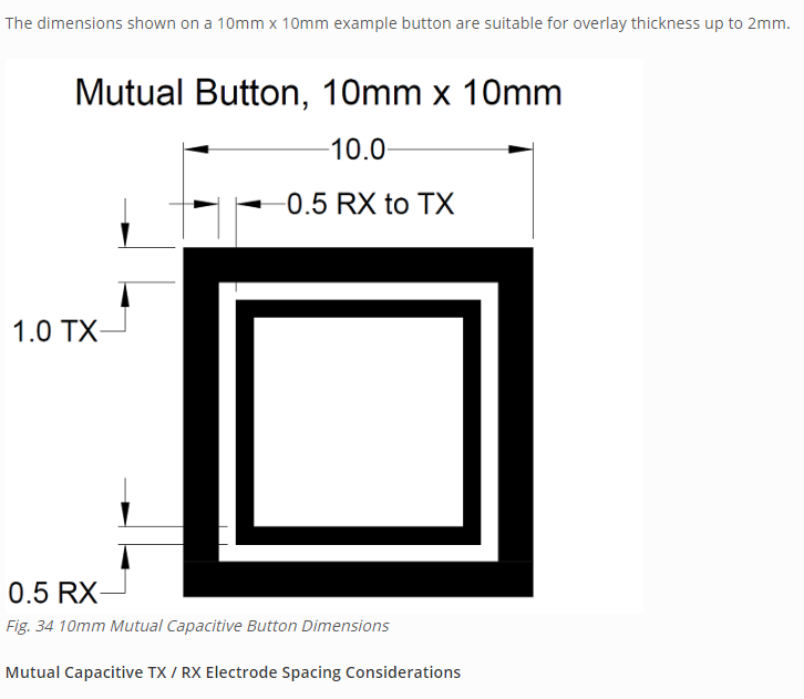

According to design guide, each button is placed side-by-side.
Customer is thinking to distribute these buttons equally on a big PCB (around 50cm x 10cm).
Do we need special consideration in layout in case buttons are separated on bigger PCB?
