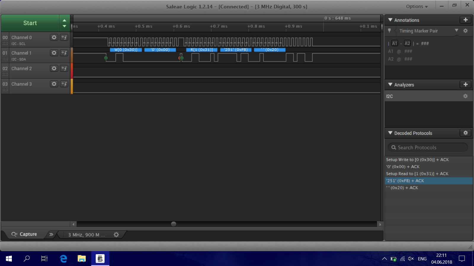

Logic analyzer capture:
As you can see, I need to issue the stop after 0xFB is received. As stated at p. 103 of the accelerometer's datasheet, the master should send NACK + STOP to end the transfer, but this happens at the second byte, not at the first one as I needed.
I've tried the code presented in this topic, but it does not work as expected. This is the logic analyzer capture:
Can anybody help me out with this issue?
  • Section 26.3.4.2.1 of the MSP432 Technical reference manual (SLAU356) has a paragraph that states:
    When transmitting a single byte of data, the UCTXSTP bit must be set while the byte is being transmitted or any time after transmission begins, without writing new data into UCBxTXBUF. Otherwise, only the address is transmitted. When the data is transferred from the buffer to the shift register, UCTXIFG0 is set, indicating data transmission has begun, and the UCTXSTP bit may be set. When UCASTPx = 10 is set, the byte counter is used for STOP generation and the user does not need to set the UCTXSTP. This is recommended when transmitting only one byte.
    The current MSP432 I2C examples do not demonstrate a single-byte receive after restart, so it's difficult to figure this out based on those examples. The code below will write some bytes (i.e. an address to an I2C EEPROM device) and then read back a single byte.  This is a preview- this example will be added to the MSP432 SDK in the next release...
      - Bob L.

  • Thank you, it worked! This is the code modified to work in polling mode, if it is helps anybody:
