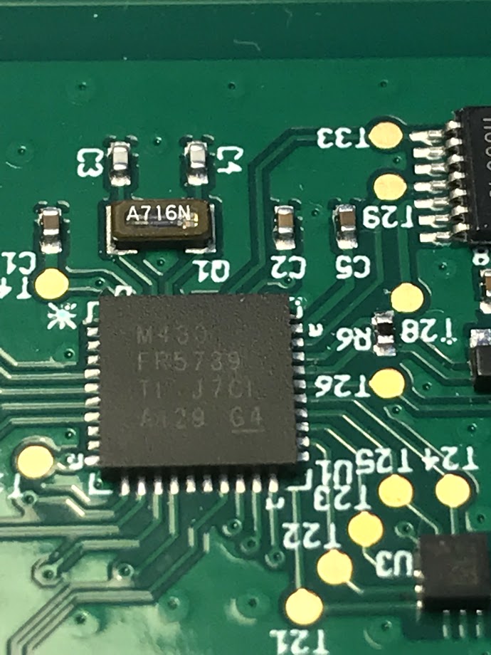

we have a custom board where a mems accelerator is connected via SPI to the MSP430FR5739. With the latest production of 1500 boards (another 1500 are waiting for production) we figured out a current consumtion with a high variation starting from 0.9 uA, which is as expected,  up to 1mA, which is far above expected numbers. All boards should enter LPM4.5 and having somthing arount 1uA of current consumtion. With previous productions of the board (4000 boards in total within the last 3 years) we had no problems with current consumtion.
I've done a firmware based on a LPM4 example which will reproduce the problem (see code below). When i put the red marked code line in comments, everything is fine and the current consumtion is 1.2uA. When uncommented, the consumtion is increased (fixed to a certain value for a certain board). With borads from previous productions there is no difference (MSP430fr5739 Revision H and J), either versions (commented and uncommented) are working fine. Ive measured the current consumtion on the Vcc input with different multimeters showing the same numbers.
Port settings are as port functions in use, unconnected ports are set as output low value. The marking on the MSP430 chips of the new board are: MSP430FR5739 TI J7C1 A129 G4

  • Hi Gary,
    1. search for the post "MSP430FR5730: How to reduce power consumption in LPM4". its says "turn off all unsued modules". If you look at chapter 1.5 in the MSP430FR5739 UserGuide it's saying "Peripherals should be switched on only when needed."
    2. it make only a minor diffference. the current consumtion of one board with "=" is 50uA and with "|=" its 180 uA. With commented line its 0.9uA!
    3. It's Hardware Revision J. (see attached foto)
    regards
    Michael
