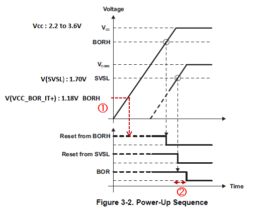

Please look the following image. I made it based on MSP430i2040 datasheet - SLAS887A and MSP430i2xx FamilyUser's Guide - SLAU335
  1. BORH is actually V(VCC_BOR_IT+) =1.18V. It’s very low from VCC (2.2V to 3.6V). How to grantee VCC is within Recommended Operating Conditions VCC (2.2 to 3.6V) before BOR is released?
  2. How much is the delay time from the reset from SVSL to BOR?
  3. How to behave the device if VCC doesn’t become the VCC spec at BOR is released?
The customer worrys that BORH and SVSL couldn’t detect VCC low voltage.

    before I answer your first question, let me answer your second. Please have a look at picture below. As you can see, BOR is generated by ORing of BORH and SVSL. That means as soon as both signals are 0, BOR becomes 0. We don't specify this time, but it is very short.
    To your first and third question:
    In principle there are three cases:
    1. Voltage is below 1.7V. In this case device stays in reset as BORH is above the reset level, but SVSL is still high. The device will not run.
    2. Voltage is above 2.2V. In this case the device will start after BOR is released and it is safe to execute code.
    3. Voltage is between 1.7V and 2.2V: In this case the core voltage is safe and you can execute code. As the voltage is below the recommended operating condition for VCC, you cannot use eg. the ADC. You need to monitor the voltage with the Voltage monitor and wait until it is at a safe level.
