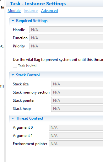

Dear,
I use to create tasks by coding, not graphically.
Today, I wanted to test xgconf for MSP432 and my fields are filled with N/A.
Is this something expectable? Otherwise, what am I doing wrong? :)
 Pease let me know! Have a nice day :)

  • Hi Bob,
    I am opening the file from the TI-RTOS project folder, right click, open in xgconf. I do not think is the same issue as the link you indicate me.
  • Can you try importing a new TI-RTOS project, building it, and then trying XGCONF again?
    -Bob L.
  • Hi Bob,
    nope, for all MSP432 projects, I cannot fill any field. The ones in the "Module" tab can be edit, though! But the ones in "Advanced" tab seem disabled and with the text "N/A" in them.
  • OK, I've forwarded this to our tools team to see if they can help.

  • Hi Kazola,
    Does the application build properly? Can you do a rebuild of the kernel project (or if the .cfg is in the application project, rebuild it). Then copy and paste the build output into a file and attach it (please attach the file instead of copy/paste into the thread to keep it shorter). This is an easy way to see all the versions being used (e.g. SimpleLink SDK, XDCtools, compiler, etc.).
    Can you attach your .cfg file also?
    Todd
  • Sure! Please find it here both files for the simplest project (empty.c), but it happens to me for all of them.

  • Hi Kazola,
    This is a known issue with CCSv8. It slipped through because we defaulted editing the .cfg as a text file instead of XGCONF in 7.1 (or so), so not many people use XGCONF now.
    You can still edit the file as a text file to add statically created tasks via Task.create (or create them at runtime via Task_create).
    Todd
  • Oh, ok. Good to know has nothing to do with my setup :)
    Thanks to all!
