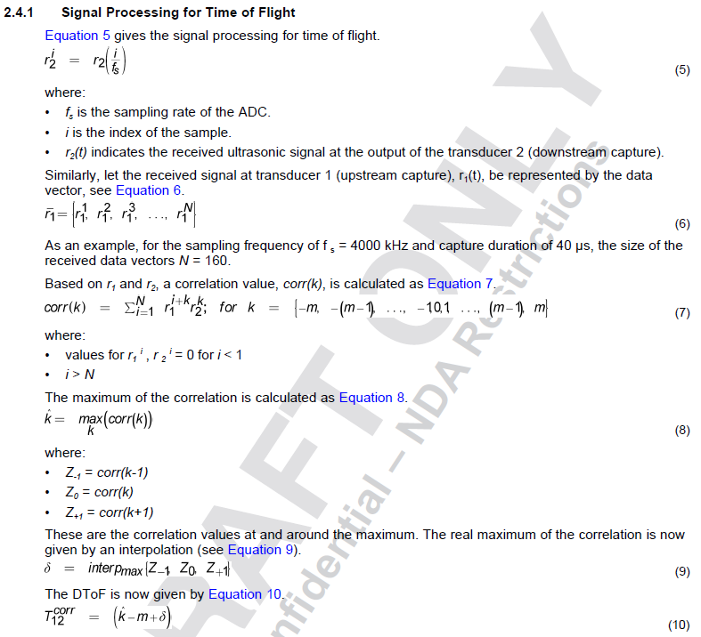

I have found information about the cross-correlation method for determining the differential time of flight used in the EVM430-FR6047 demo in
TI Designs: TIDM-1019 Ultrasonic Sensing Subsystem Reference Design for Water Flow Measurement
www.ti.com/.../tidudn0.pdf
Page 8 & 9
as well as in
High precision & accurate sensing at lowest flow rate for metering applications
http://www.ti.com/lit/ml/swmp003/swmp003.pdf
Page 12 & 13
but the two write-ups seem to be conflicting in detail. Also the formatting of the first one is horrible. Because of this I have not yet understood what exactly is happening, so my question is: Is there a clean or more detailed write-up?
