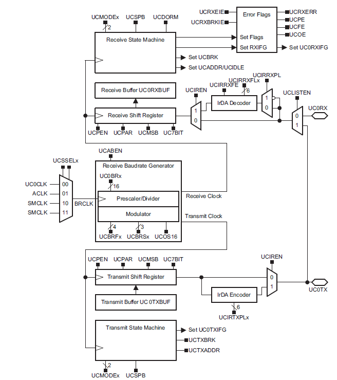

  • here is the schematic for the UART
    Here is my code:

    When viewing the device manger, I only see a single COM port connect, which is unlike the image your provided. I am not using a MSP-FET device though, it is connect to the computer through an USB.
    What is this USB device? Please provide a detailed description. The CCS error in your initial post makes sense if you're trying to program the device or communicate over UART without using one of our tools, such as the MSP-FET or an eZ-FET. If you're using a generic USB-to-serial adapter, CCS doesn't need to know about it (and most likely doesn't support it), only Putty does.
    James
    MSP Customer Applications
  • The device I am using is the eZ430-RF2500 Development Tool. Here is an image of the device
    Thank you! OK, things are starting to make more sense.
    There seems to be an issue with your clock or baud rate settings. Using your code on the eZ430-RF2500, I could enter the UART RX ISR, but the RX buffer had 0xFF (didn't match the keyboard input), so I suspected it's a baud rate issue. Using the code below, I got the "Hello World" to show up in Putty after I entered the "u" character.

    I hope this helps.
