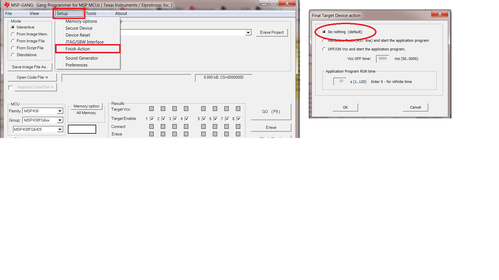

MSP-GANG: do nothing setting issue after program completion with MSP-GANG tool offline programming for MSP430
Part Number: MSP-GANG
MSP-GANG Programmer tool for MSP430 offline programming, and use the default setting for do nothing after program completion.

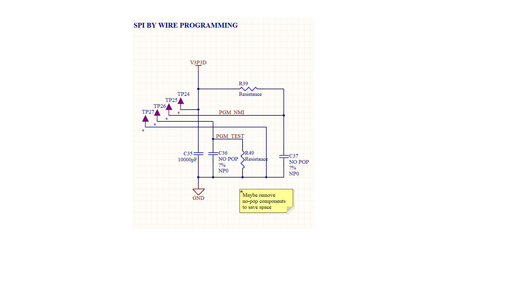

the MSP430 should be held in reset status all the time after program completion, but i can see that the RST pin voltate is released and hold high some time later.
you can refer to the waveform, TP25 is the RST/NMI pin voltage and TP26 is the TEST pin.
So pls help check if the programmer GUI setting has some problem for the do nothing setting which can not match the msp-gang user guide.
how i can realize the MSP430 can be held in reset status all the time after program completion if do nothing can not work.
